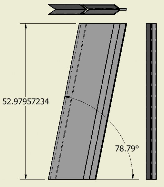

I'm new to Inventor 2014 and am having trouble with it's capabilities.
I have a vertical part..rotated in several directions (see below). The top and bottom needs to be level with the ground plane when all is done. Chopped flat.
Plan view - rotate it 37.023 degrees
South elevation - rotate it 2.46 degrees to the left.
West elevation - rotate it 8.75 to the right.
I tried to create a 3d void in the South view, but it first needs a plane to start.....which is rotated and skewed a bit. Can I project a sketch in the South view and use as a void to remove from the piece?
Thanks for any help.
Mike

So sorry for that. I figured it out. I created a plane by using Angle to Plane Around Edge. I enabled the visibility of my XZ plane and Z axis. Worked like a charm.
Here's my end result. What do you think?

I assume you are going to use some assembly constraints.
This might be an interesting solution (see attached).
