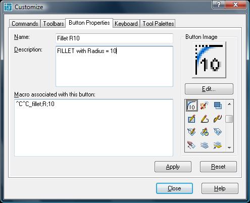

Raggi_Thor Posted December 12, 2008 Share Posted December 12, 2008 Thias was easier in older versions, but maybe CUI can be used? Make some buttons for your favourite fillets? Quote Link to comment Share on other sites More sharing options...
