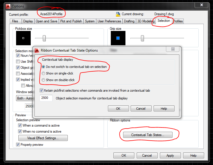

ReMark Posted July 30, 2014 Share Posted July 30, 2014 Are you referring to the "Contextual Tab Display" feature? This is what it looked like in 2014. You will not find the three listed options in 2015. They were removed. Quote Link to comment Share on other sites More sharing options...
banyfuentes Posted July 30, 2014 Author Share Posted July 30, 2014 Yes. I'm trying to lock it but I cant. I've tried the RIBBONSELECTMODE and hasn't worked. Quote Link to comment Share on other sites More sharing options...
ReMark Posted July 30, 2014 Share Posted July 30, 2014 No longer available in 2015 as far as I know. Quote Link to comment Share on other sites More sharing options...
