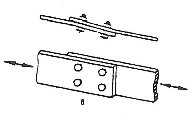

rgarcia5 Posted July 30, 2014 Share Posted July 30, 2014 Just wondering how to make a slight bend on an object like the picture below. This is what I have done so far. I am using AutoCAD 2015 Figure 3.1-8.dwg Quote Link to comment Share on other sites More sharing options...
tzframpton Posted July 30, 2014 Share Posted July 30, 2014 Instead of extruding the flat, extrude in the transverse, after creating a profile that recreates the slight bends. Quote Link to comment Share on other sites More sharing options...

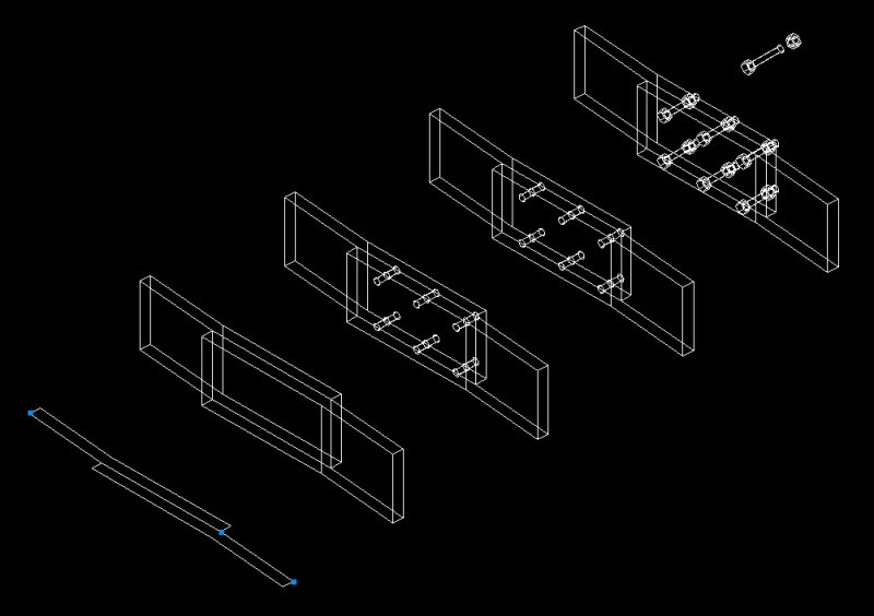

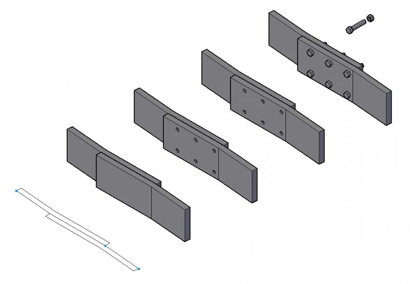

ReMark Posted July 31, 2014 Share Posted July 31, 2014 (edited) As previously suggested, to get your plates to "bend" you start with a different 2D profile. Then you can give it a height. I assume you want this to look as accurate as possible so I would suggest you put holes in your plates and create a bolt with a separate nut to be copied to each hole. Note: My drawing is for demonstration purposes only and is not meant to be an exact duplicate of yours. If you would like a copy of the drawing file itself just let me know. I'd be happy to attach it to a subsequent post. Edited July 31, 2014 by ReMark Quote Link to comment Share on other sites More sharing options...
ReMark Posted July 31, 2014 Share Posted July 31, 2014 The same drawing with a Conceptual visual style. Clearer now? Yikes! Just noticed I have two sets of plates with holes and no bolts instead of one. My bad. Haven't had my ten cups of coffee yet. A close-up view of the back of the plates. Quote Link to comment Share on other sites More sharing options...

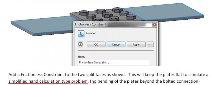

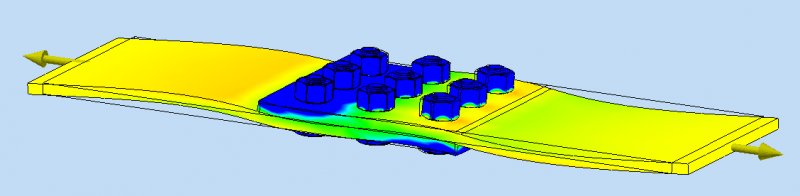

JD Mather Posted July 31, 2014 Share Posted July 31, 2014 Doesn't statics deal with rigid bodies that do not bend? Well, this problem in particular is near the end of the semester and serves as a lead-in to my following semester FEA class. Statics and Strength of Materials 7th ed. H.W. Morrrow Chap 18, Pg.446 Problem 18.1. This happens a lot where I tie follow-on classes together. For example in Statics class we calculate friction force impending motion where a box is just about to slide up or down an inclined plane. Dry stuff with just classical calculations. Now let's test our calculated results in Dynamic Simulation. Introduction in the Statics class to the Dynamics class to follow. 21st century software tools that bring this stuff to real meaning, not just some abstract numbers on a sheet of paper. More like the real world. Quote Link to comment Share on other sites More sharing options...

rgarcia5 Posted July 31, 2014 Author Share Posted July 31, 2014 ReMark, Once again thank you! Quote Link to comment Share on other sites More sharing options...

JD Mather Posted July 31, 2014 Share Posted July 31, 2014 With the increased pressure to add more to the engineering curriculum.... I have started using Autodesk ForceEffect quite a bit in my Statics class. The students are supposed to have already covered all the basic math in their math and again in their physics class, so I had to ask others, "Why am I doing this again?" The response, "They didn't get "it" in those classes." So now you want me to use the same classical failed approach? Funny thing is, I have been able to add a tremendous amount of new content in a way that brings the book problems "alive". Where I used to pick out a handful of problems to illustrate - it would take so long to set up the calculations, that only a handful could be done. And what do we end up with - a bunch of abstract numbers that have little real-world relevance to the students. Because I start out in single part FEA and then assembly FEA I think it would be better to combine our Statics with Dynamics in a single course to run concurrently with the FEA class. I have already made plans to do this curriculum change. Most of my structural engineering colleagues have no idea of the existence of constraint-based CAD modeling and the benefits it can provide engineering students. They still look at CAD as a drafting tool. These software tools are now full-featured digital prototyping design tools - drafting is almost a by-product. I was doing a problem with my students last year from a book that the author makes a statement, "But by using traditional techniques, the student can concentrate on the kinematic theories and will not be "bogged down" with learning CAD commands." Sounds to me like the author didn't have the aptitude for setting up DOF sketches. We searched and found the mechanism already modeled on GrabCAD and made it "come to life". Didn't get "bogged down" by anything! I hope you don’t mind me getting off topic a bit but this has been fun. We should take this discussion off-line, there might be some areas we could collaborate on. jmather_at_pct_dot_edu Edit: I had to add this image from my final exam. Note that I instruct the students to add a non-existing (in real-world) constraint to the problem so that the results numbers match the simplified hand-calculations from the book's classical solution (which we have set up in an Excel spreadsheet). (I just now added the red underline.) Quote Link to comment Share on other sites More sharing options...
