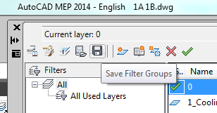

I'm looking to export layer filters (but not the layers themselves) to use in another drawing.
I saw someone posted a screenshot in 2009 of the layer palette, which had a button to do this. But I can't seem to find this functionality in 2014. Any tips?
In Layer States Manager you can Import and Exportn layer states.
... but the OP is about Layer Filters.
It's not here?
No, unfortunately not! Neither classic mode nor the layer palette gives that option, for ACAD Vanilla anyway. I heard they had it in R2009, but it was removed because adding an xref added in all the referenced files' layer filters...nightmare.
I'll have to give the lsp option a try, though I'm sure I read somewhere that it only works with group filters. Still, if that is the only way!
My only other idea is to create a template with all the filters I need, then purge the layers themselves...
