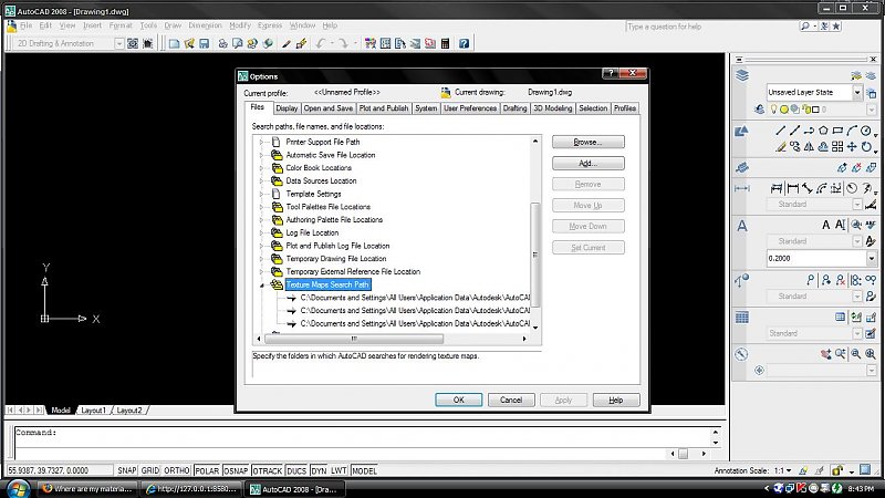

stevsmith Posted December 10, 2008 Share Posted December 10, 2008 When I installed Vanilla 2008. I deleted the material files from the Tool Pallet window. How can I find them to reload them back into the tool pallet? Quote Link to comment Share on other sites More sharing options...
papagyi Posted December 10, 2008 Share Posted December 10, 2008 You can copy texture folder from install cd and paste to adress according to your acad "options" "texture" files path! Quote Link to comment Share on other sites More sharing options...

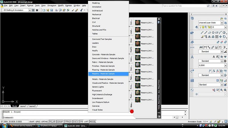

arjun_samar Posted December 12, 2008 Share Posted December 12, 2008 hi papagyi can i ask something? about materials. when i heard about acad 2007 they say threre are so many installed or template materials. but when i got acad 2007 in my computer i cant find materials. thats why when im rendering im just using materials that i downloaded in the internet. Quote Link to comment Share on other sites More sharing options...
Cad64 Posted December 12, 2008 Share Posted December 12, 2008 when i heard about acad 2007 they say threre are so many installed or template materials. but when i got acad 2007 in my computer i cant find materials. Arjun, at one point, during the installation process, you were given the option of installing the materials library. Did you do this? If so, then you should be able to find the materials in your Tool Palette. Quote Link to comment Share on other sites More sharing options...
papagyi Posted December 12, 2008 Share Posted December 12, 2008 By ..".Ctrl +3"with Check your material library or template ! At that time ,you will see tool palettes and click on area of red circle according to my attach image. If you will see like as my attached image, material template already had!If not,you need to install or copy and paste texture folder from your installation cd! Quote Link to comment Share on other sites More sharing options...

arjun_samar Posted December 14, 2008 Share Posted December 14, 2008 By ..".Ctrl +3"with Check your material library or template !At that time ,you will see tool palettes and click on area of red circle according to my attach image. If you will see like as my attached image, material template already had!If not,you need to install or copy and paste texture folder from your installation cd! big bro papagyi.. i just browse the folder textures, yup there are materials... but all of them seems in grey color... is it true that there are almost 300 materials in acad2007? coz just read it on help in acad. topic materials... thankss.. big bro.. Quote Link to comment Share on other sites More sharing options...
papagyi Posted December 14, 2008 Share Posted December 14, 2008 Ya!Now you should do like that as i said "stevsmith"! Quote Link to comment Share on other sites More sharing options...
