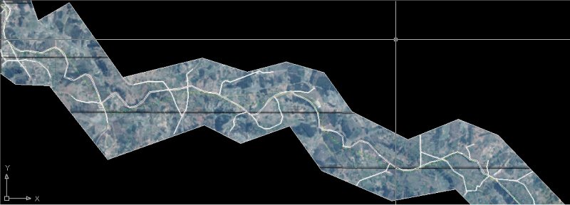

A simpler suggestion is to break the lines as you draw them you would need a lisp though, draw a line and offset and break I will see what I can provide I have a solution but its copyrited. From a architectural point this is common for wall intersections.
@BIGAL: Thanks. But I still did not get your suggestion. I need to draw the layout of road map system after redraw base on inserted google map pictures as below:
Kindly help if you have any solution.
