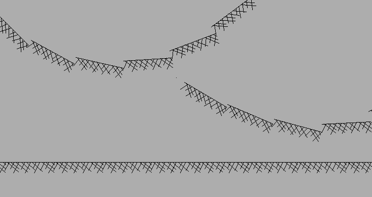

Parellada Posted August 21, 2014 Share Posted August 21, 2014 Hello to all. Someone me would be able say create like the parameters (file *.lin) of this type of complex line for Autocad 2013. I accompany file Línea_de_tierra.dwg Quote Link to comment Share on other sites More sharing options...
BIGAL Posted August 22, 2014 Share Posted August 22, 2014 Rather than a line a hatch pattern ? Try Earth Quote Link to comment Share on other sites More sharing options...

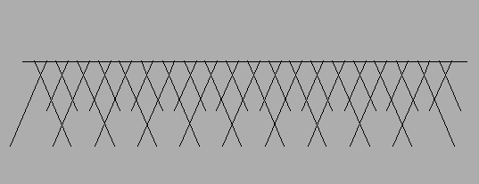

Parellada Posted August 22, 2014 Author Share Posted August 22, 2014 Bigal, good afternoon in Australia. It is a line pattern. It does not load the line because you would lack the file of support lstyle.rsc of microstation v8. The line is the "Ground Line" of microstation v8. But on having moved her of drawing it loses his aspect. It looks at the attached jpg and this it would be the definition of the outline. Because of it I need to define it like *.lin to add it to the file ACAD.lin. There would be necessary to create a s*.hpe, a *.shx and one *.lin Graces and regards Quote Link to comment Share on other sites More sharing options...

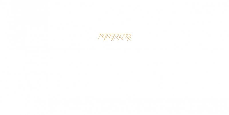

eldon Posted August 22, 2014 Share Posted August 22, 2014 If one were really desperate, something like this is possible. All done using the letter "v" and only works for a particular font - not very practical. I would favour a block and use array or measure. Quote Link to comment Share on other sites More sharing options...
Parellada Posted August 22, 2014 Author Share Posted August 22, 2014 Hello. Evidently the problem is of sources, but I have a project with this line and on having changed drawings it loses the definition. I have created the files (shp, shx and lin), that should draw it but it gives me mistake when the file tries to load line. I accompany files. Thank you for everything and regards Tierra.zip Quote Link to comment Share on other sites More sharing options...

eldon Posted August 23, 2014 Share Posted August 23, 2014 I have created the files (shp, shx and lin), that should draw it but it gives me mistake when the file tries to load line. I accompany files. Thank you for everything and regards What mistake does it give you? I managed to load it perfectly, and drew some lines. Make sure that the shape file is on the search path. It would seem that the linetype would only be suitable for straight lines and there is a blank at the ends because the shape is of unit length. Well done for getting so far. Quote Link to comment Share on other sites More sharing options...
Parellada Posted August 23, 2014 Author Share Posted August 23, 2014 Good night The problem had it for wanting to draw directly and what you should have done was to reload the line with the new way. Many thanks to all. Without their help I would have not succeeded. Quote Link to comment Share on other sites More sharing options...
