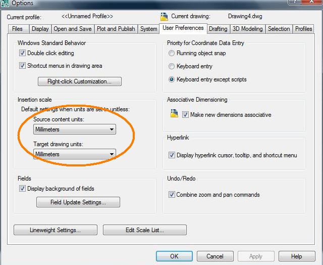

I don't agree with this statement. The settings for unitless blocks is controlled by the setting in options (see below) as opposed to the insunits system variable. If you insert a unitless block with the settings as below into a metric drawing, it will insert at the correct scale.

the screen shot posted shows the insunitsdefsource and insunitsdeftarget variables which do force the inserted blocks into the correct units. The variables Dip posted do similar things too but I can't remember what. When these variables were first introduced (2004?) they weren't on the options button and took some time to find. If you are only drawing in one measurement system setting these in your dwt will serve you well.

The insunitsdefsource and insunitsdeftarget variables are specifically for unitless blocks and with the 'source' variable you can apply whatever units you want to a unitless block. insunits is powerful for controlling blocks that have the units set. You probably know this already - I'm writing it to get it straight in my own head. :)
