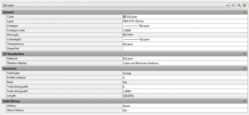

Im looking for a lisp to sum the values of 3d pipe solids , each pipe own its own layer ,represent different diameter.
The info exist in the properties palette .( see picture attached -"Length")
It seems that this property isn't available through VLisp ActiveX...

Dont know why but the sum values are incorrect , to sweep pipe im using this lisp

is it possible to create a program that ignore all other objects unless they have in propeties under 'geometry' the "length" data?
I have to revive this thread... It isn't solved as should... If someone knows how to access Geometry properties of 3DSOLID entity, please reply... The problem are sweeps with curves as paths, and also if accessed Geometry properties that info could be useful for all other types of 3DSOLID entities...

im also waiting if there's someone who can do it ... if this info exist in properties there's must be a way !

Finally there is a solution, Check out this page Here theres also a video showing this lisp in action
Thanks , exactly what i was looking for!!!:):):D
