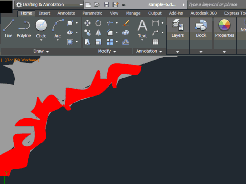

nestly Posted September 15, 2014 Share Posted September 15, 2014 I believe the TRIM problem may be because the Hatch is not continuous. I had to edit the boundary of the red Hatch so it doesn't intersect itself before I could TRIM it. Other than that, I don't know. Quote Link to comment Share on other sites More sharing options...

nestly Posted September 15, 2014 Share Posted September 15, 2014 Yeah, that is odd. I can TRIM hatches without Exploding whether they're created by Pick Point, or by Object.... whether they're Associative, or non-Associative, and whether the boundary is retained, or not retained. AutoCAD2011 thru AutoCAD2015 Quote Link to comment Share on other sites More sharing options...

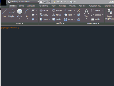

macmongo Posted October 4, 2014 Share Posted October 4, 2014 Just curious, (newbie here) how did you record that nestly? Quote Link to comment Share on other sites More sharing options...
nestly Posted October 4, 2014 Share Posted October 4, 2014 Recorded and converted to an Animated .gif with Camtasia Studio. An alternative is to use any of the free screen capture programs, Windows Movie Maker, and upload to Youtube. Quote Link to comment Share on other sites More sharing options...
