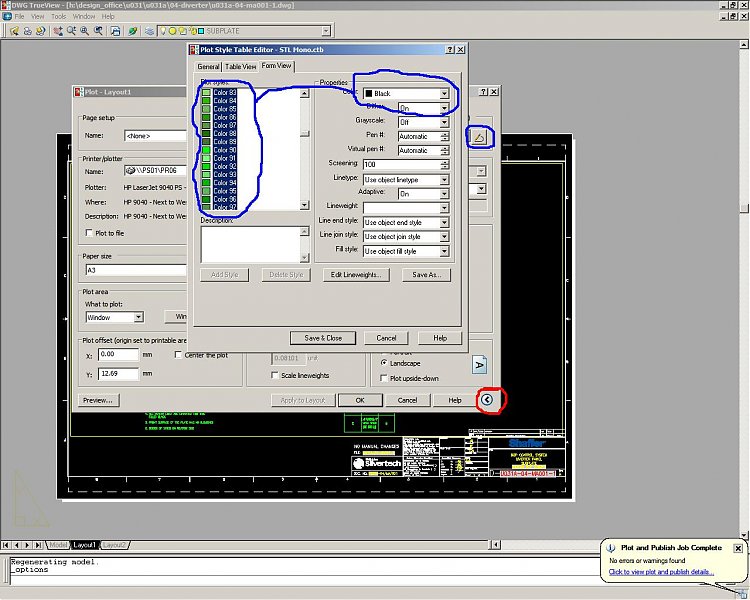

dbroada Posted December 11, 2008 Share Posted December 11, 2008 start plot and select a mono ctb file. You may have to enlarge your plot box to see all the options. Click the arrow in the lower right corner (seen here already clicked) Quote Link to comment Share on other sites More sharing options...
