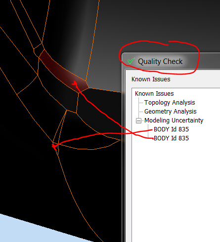

JD Mather Posted October 1, 2014 Posted October 1, 2014 Try this file. (see attached dwg) Hmmm, well the filesize is too big to attach. Quote

JD Mather Posted October 5, 2014 Posted October 5, 2014 Do you have an Autodesk 360 account? The repaired file is too large to attach here. Do you have access to Autodesk Inventor (not really needed, as I have already done the repair, but if you wanted to do it yourself....). Quote
bavdeyka Posted October 5, 2014 Author Posted October 5, 2014 Hi JD! I've just created an account, my name there is Konstantin Makarov. And I have access to Autodesk Inventor, so if you could find a minute to explain how you did the repair, that would be really nice. Quote
JD Mather Posted October 5, 2014 Posted October 5, 2014 https://myhub.autodesk360.com/ue29ccac3/shares/public/SH7f1edQT22b515c761e88fa778764b9d75d http://home.pct.edu/~jmather/AU2008/ML205-1P%20Mather.pdf Quote
