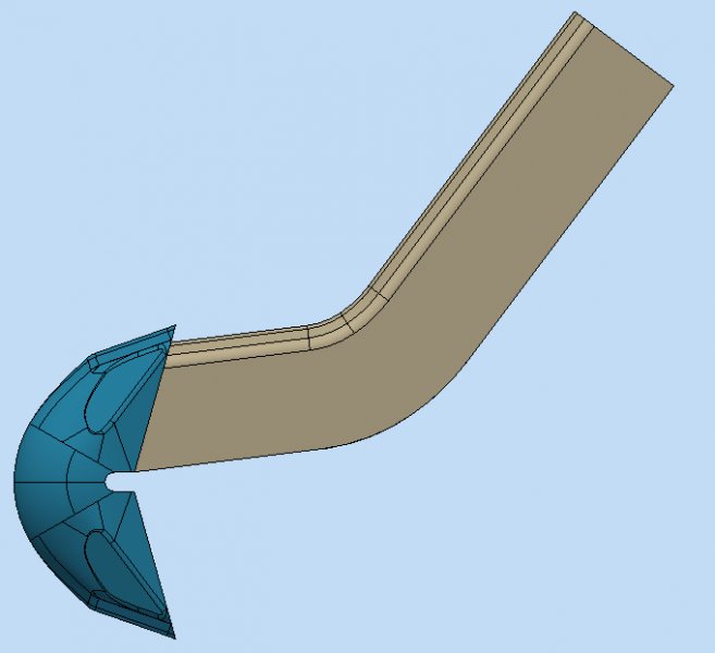

bavdeyka Posted October 11, 2014 Author Posted October 11, 2014 Glad to see you, ReMark! I cannot perform boolean operations on the model. I need to delete parts marked with red arrows up to the place where the objects cross. I tried to do it by extraction of objects, but every time both autocad and invertor say there's an error - and I can't understand why it's so. http://pixs.ru/showimage/bcubejpg_9937325_14167812.jpg Quote

JD Mather Posted October 11, 2014 Posted October 11, 2014 How far from the origin (0,0,0) is you geometry? Is something like this your design intent? Quote
bavdeyka Posted October 11, 2014 Author Posted October 11, 2014 Hi JD! As I got it, you asked about this http://www.4shared.com/download/_9Wu5opIba/bcube2.jpg?lgfp=3000 That's great!!! Yes, it is, but it's actually a half of what it was intended:) I wanted also to cut off the part marked by an arrow at the place of junction of the two objects. http://www.4shared.com/download/iZ791Cjbce/Slice2.jpg?lgfp=3000 Quote
GP_ Posted October 11, 2014 Posted October 11, 2014 This is my attempt http://www.fileconvoy.com/dfl.php?id=gcc4c793e1e8ab184999567892e2819ca798bcf85c Quote
bavdeyka Posted October 13, 2014 Author Posted October 13, 2014 GP_, thank you! It's almost there - but I still need a smoother intersection from the inner side. I managed to make this out of your drawing: http://www.fileconvoy.com/dfl.php?id=g71f581d07b8982409995683363ffda4bbb0b1ceeb But I faced the same old problem - I can't combine two objects into one again. If I managed this, the issue would be over). Could you prompt me how I can do it and how you managed to crop the previous drawing at points of intersection? Please, check your private messages. Quote
