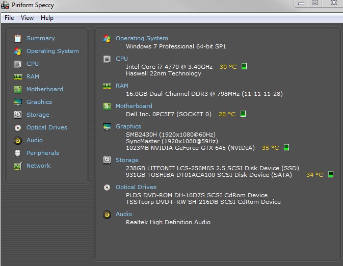

f700es Posted October 14, 2014 Posted October 14, 2014 One of the best ways out there for system information! https://www.piriform.com/speccy The free version should be enough for most anyone. If and when you install make sure you un-click the Google Toolbar add-on :rolleyes: Quote

Handiman Posted October 15, 2014 Posted October 15, 2014 f700es - Thanks for the software link. That is good info. Thanks to your suggestion I was able to find out that my i7-3770 4 core processor @3.4GHz has 800MHz memory. Thank You Dell. Yes it was only a $1900 computer that my boss selected. Yes a Dell computer works but for that money there is a lot more performance available. Quote
f700es Posted October 15, 2014 Posted October 15, 2014 The google toolbar. That thing came with my new terabyte SSD external, and my new scanner. It's everywhere. I's everywhere. WOW, I just installed speccy. What an eye opener. Yes it does and it catches people off guard at times. Glad you are digging Speccy Quote
f700es Posted October 15, 2014 Posted October 15, 2014 f700es - Thanks for the software link. That is good info.Thanks to your suggestion I was able to find out that my i7-3770 4 core processor @3.4GHz has 800MHz memory. Thank You Dell. Yes it was only a $1900 computer that my boss selected. Yes a Dell computer works but for that money there is a lot more performance available. No problem Handiman Yeah I have a new Dell at work and I am more than pleased with it. I am a big Dell fan. I have 2 Dell desktops, a laptop and 2 Venue tablets at home from them. Specs from my work PC Quote
