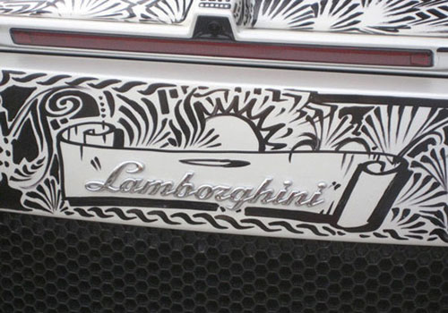

As for the image posted above, what part(s) of it do you wish to trace? The lettering? The background design? Both?
If you had a digitizer you could tape the image to the board, set up a simple two point coordinate system, and electronically trace it without a problem.
My last belt buckles were done using both autocad and also edgecam. They were much simpler designs.
Sorry I forgot to specify that I would just like the black outlined as I am either going to pocket or raise it. I plane on putting my last name instead of lamborgini in graphiti styled letters.

Is that the only image you have? It appears as though it was taken at an angle. Do you have a straight-on shot?
I trace images from time to time. I insert the image into a drawing, lower the fade and start tracing over the top of it, then do lots of editing after the fact with the image move above the lines and circles for reference.
I'd recommend having it digitized as I believe it would provide better accuracy if a good head on image can be captured.
Unfortunatly that is the closest to a head on picture of it. I have others but only at greater angles. Can I still digitze it? And if so how?

I have a digitizer. Normally I would take an image, tape it to the digitizer, calibrate it (establish temporary coordinates for the lower left and upper right hand corners) then trace it over using polylines. After that it is just a matter of tying up and loose ends and saving the drawing.

Adobe Illustrator CS3 is what you need for this. Use the Live Trace and this will convert to a vector image in a couple of seconds. Then you can edit whatever parts you want. The name wont trace very well though as the edges aren't very well defined but this could be overcome by typing in a similar font.
