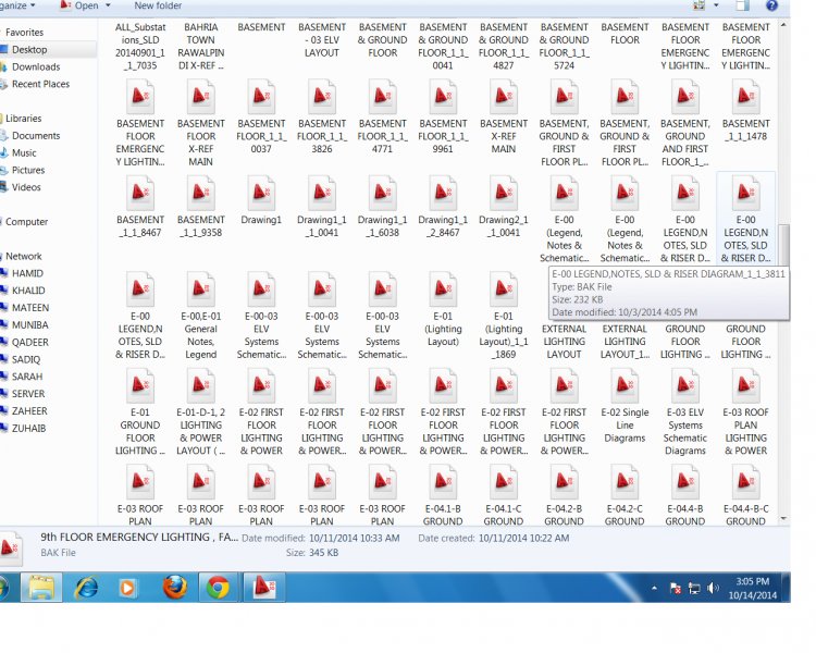

zuhaib Posted October 14, 2014 Author Share Posted October 14, 2014 i want to make bake up file for my cad drawing thatswhy i apply movebak command and gave the location of folder. but when i check the bake up file it does not work it does not open........ it look like that... Quote Link to comment Share on other sites More sharing options...

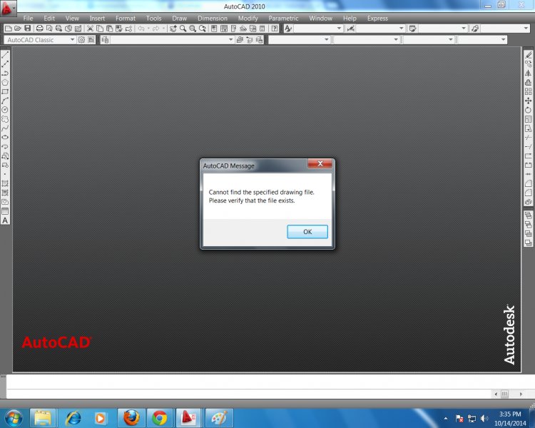

zuhaib Posted October 14, 2014 Author Share Posted October 14, 2014 yes dear i also tested. it is working in my laptop.....but it should be work in my pc ... which is not working ..... when i openning after change the extension into DWG .... its giving me message like this .... Quote Link to comment Share on other sites More sharing options...
ReMark Posted October 14, 2014 Share Posted October 14, 2014 If AutoCAD cannot find the file how do you expect it to open? How are you trying to open the file? By double clicking on it? Why are you trying to open a BAK file anyways if you have the original file? Quote Link to comment Share on other sites More sharing options...

rkent Posted October 14, 2014 Share Posted October 14, 2014 The file extension is not showing in your windows setup so when you rename the file you are actually getting E-01.DWG.BAK First set Windows to show file extensions, then rename the file, then it will work as expected. Quote Link to comment Share on other sites More sharing options...
