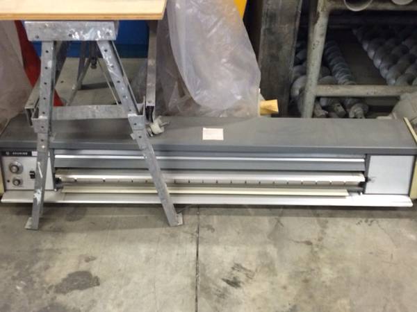

Dana W Posted October 22, 2014 Posted October 22, 2014 :lol: Yeah! I remember a tee square too, & a print machine with a carbon arc kinda light. The original velum was captured in a curved plexi glass frame along with sensitive print paper. The light came down slowly in front of the frame to fix the print. Circa 1951. I was 18. It all seems like a dream. Will check out the chat. Thanks for the laugh. Keith. My first blueprints, actually blue line prints came off a Bruning Diazo process machine that used 25% anhydrous ammonia fumes to "fix" the prints. Holey **** what a smell. That was in 1971. It looked just like this one. Quote

jack nastyface Posted October 23, 2014 Author Posted October 23, 2014 My first blueprints, actually blue line prints came off a Bruning Diazo process machine that used 25% anhydrous ammonia fumes to "fix" the prints. Holey **** what a smell. That was in 1971. It looked just like this one. Yes Dana, the same machine my company was using just before I retired in 1998. It did the job but should have been sent to a museum. Now finished the drawing & must say that I had never used the limits option in "dimension style" before. Where I need to practice more is in the paper space & "viewports". Quote
