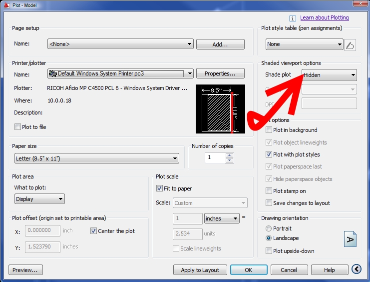

Swihfr01 Posted December 12, 2008 Share Posted December 12, 2008 I'm trying to write something in Arial font (True Type i think) and I keep getting just an outline of the letters. I want it to be filled in. I haven't tried exploding the text and filling the letters manually because I know there has got to be an easier way. fillmode = 1 and textfill =1 When you change fillmode or textfill via commandline do you have to do something else to update the drawing it or does it happen immediatly? I've tried changing fillmode and textfill and running regen but the text dosn't change at all. I'm using AutoCAD 2005. Please Help Quote Link to comment Share on other sites More sharing options...

Swihfr01 Posted December 16, 2008 Author Share Posted December 16, 2008 UCS>WorldPLAN>World Shademode> 2d textfill> 1 Usually one or more of those. Ive checked all of those and they don't solve the problem. Problem: When I create the text it's filled in. When I look at the "Layout" tab the text is filled in. But when I open Print Preview all text is drawn as outlines. Here's the file Hollow text.dwg Quote Link to comment Share on other sites More sharing options...

Swihfr01 Posted December 16, 2008 Author Share Posted December 16, 2008 MVIEW, SHADEMODE, 2D, select the viewport edge.I don't have AutoCAD open but I think that is the sequence after starting the MVIEW command. Also, did you set PLAN and UCS to World in the viewport with the viewport unlocked? OK I tried what you suggested in both Layout and Model views. Layout seems to be fixed ie. text shows up as solid in both Layout and Print preview. However, Model still shows text as outlines in print preview. Quote Link to comment Share on other sites More sharing options...
GhostRider Posted December 16, 2008 Share Posted December 16, 2008 you have it set to plot a hidden view, change that pull down to as displayed and I think your text will be filled like this : Quote Link to comment Share on other sites More sharing options...
Swihfr01 Posted December 16, 2008 Author Share Posted December 16, 2008 Thank you so much. It's fixed now. This problem has been bugging the hell out of me. I didn't even know I had those options. They were hidden until I clicked the arrow in the bottom corner. Quote Link to comment Share on other sites More sharing options...
