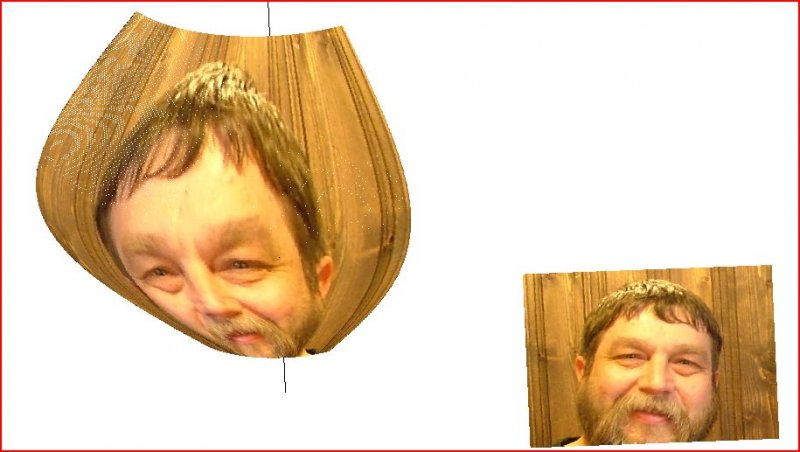

Kuli24 Posted November 4, 2014 Share Posted November 4, 2014 Hey. I can't seem to figure out how to wrap an image around a cylinder in AutoCad 2012. Cylindrical mapping doesn't seem to do anything. I'm wanting to pretty much apply a decal onto the stainless steel material I have applied. Thanks. Quote Link to comment Share on other sites More sharing options...

scj Posted November 5, 2014 Share Posted November 5, 2014 It is a little bit tricky: First you have to import the jpeg into AutoCAD. I used the program DT-ImageToPixelSolid (by Mr. Holger Brische, http://www.d-tool.eu) for this. Then I transformed the "PIXELs" (small 4point-SOLIDs) onto the 3d-surface area, using my PIC2REVSURF.lsp The result is a very heavy file, about 26 MB. In case of interest you can contact me. Regards Jochen Quote Link to comment Share on other sites More sharing options...
