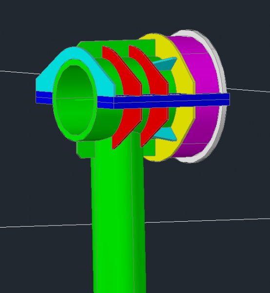

greedy86 Posted November 6, 2014 Posted November 6, 2014 So....I'm relatively new to 3D modelling. I've been using AutoCAD for a number of years now and I'm currently working for a Oil and Gas fabrication company. From time to time we have to produce a profile for cutting tubular pipes. We've software that does the simpler connections - but this one in particular was a little confusing. So I've attached a screen shot to show you how exactly the clamp goes together.... On the underside of the clamp the tubular is notched in way off the clamp stiffeners. My question to you is.....if I explode the 3D Solid (of the pipe)....and I manipulate it so I'm only left with the outer diameter of the pipe (showing the notches).....is there anyway I can then unravel/unwrap the surface to get a perfect profile of the pipe? Your thoughts and views would be greatly appreciated. King Regards. Quote

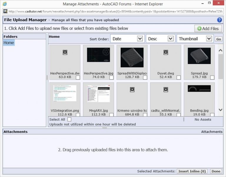

SEANT Posted November 6, 2014 Posted November 6, 2014 Use Copy and Paste to bring that one part into a new drawing file. In a new post use 'Go Advanced' (see lower right of post box). Attach the file via 'Manage Attachments' Quote
greedy86 Posted November 6, 2014 Author Posted November 6, 2014 Hopefully that's worked. That's the 3d object - I'm trying to get the profile of the outer diameter. Thanks Tubular Profile.dwg Quote
SEANT Posted November 6, 2014 Posted November 6, 2014 Well, the plugin at the Exchange was not as fruitful as I had hoped, but the next version should be better suited. See the attached. Tubular Profile_UnWrap.dwg Quote
scj Posted November 6, 2014 Posted November 6, 2014 Hi, I did some simplifications: I eliminated the gaps at the upper side and made a gap for seaming (1mm). The unfolding is based on the outer contours Hope, it works... Regards Jochen http://www.ant-ares.de Tubular Profile_scj.dwg Quote
greedy86 Posted November 6, 2014 Author Posted November 6, 2014 SEANT, Thanks for that - that is exactly what I'm looking for - however - it's not the same profile as I had already which is a little worrying. Don't get me wrong - it's similar....but it's not right! SCJ I've got software that can produce a profile like that - the slots/gaps on the upper face is what I'm requiring the profile for. I appreciate all your help though. Quote
SEANT Posted November 6, 2014 Posted November 6, 2014 "it's not the same profile as I had already" How was that derived? Quote
greedy86 Posted November 6, 2014 Author Posted November 6, 2014 Errmmmm....it was, to say the least, a very long winded approach. To cut a long story short - I exploded the 3d object so that I was left with the plan view, on just the top face. I then "flattened" that face....and then from that - got the arc lengths in order to project the top gaps onto the profile that I'd already had (using other softare). I'm not even sure you'll understand the method....? Maybe it was just madness. I just wanted a profile to make sure what I'd done was corrent - before it goes to the shop floor. Quote
