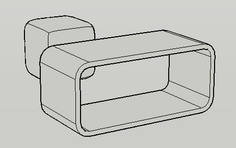

ssgp Posted February 6, 2007 Posted February 6, 2007 I have an objec in 3d,but inpossible to stretch. Is it possible? Quote
Designer Posted February 6, 2007 Posted February 6, 2007 Its possible, but its not with the stretch comand, i do not remember the comand name but i know there a comand where you can stretch the solid. Quote
ReMark Posted February 6, 2007 Posted February 6, 2007 You can also use the Move Faces command. Quote
ASMI Posted February 6, 2007 Posted February 6, 2007 You can make the block and change scale on axes in the Properies window. Quote
profcad Posted February 7, 2007 Posted February 7, 2007 Select the 3D object. Hold down the CTRL key and select it again. You should see some grips at the corners and the midpoint of the edges. Click on one of the grips to stretch that edge or corner. This works in AutoCAD 2007 or above. John Quote

ReMark Posted April 1, 2010 Posted April 1, 2010 HaxLi: Use the Move Faces command. You'll find it in the solids editting tools. Quote
HaxLi Posted April 2, 2010 Posted April 2, 2010 Use the Move Faces command Thank you, that worked out. But how easier to select faces, like lines in STRECH cmd for 2D? It takes time to select each one by one.. ;] And is it possible to make Parametric Constrains for 3D Solids that I could change length for object like for 2D ones? Thank you for you answers and time Quote
ReMark Posted April 2, 2010 Posted April 2, 2010 I'm not sure parametric constraints can be applied to 3D objects in AutoCAD. It is a feature I have only experimented with but have not used on a regular basis. Crossing windows can be used to select or deselect groups of lines that make up faces. Quote
HaxLi Posted April 2, 2010 Posted April 2, 2010 Any idea on how to make dynamic 3D solid (that shelf on pisture)? I mean the possibility to change the Length or Height by entering a value Seen something alike in SkechUp but it's not so friendly with exporting to CAD.. EDIT: Found that there's a BLOCK which may do the trick, just don't know how to do it for 3D, Extruded shell objects.. Quote
