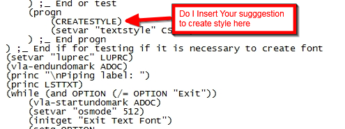

1st answer do this in code, need a sample dwg to test properly
; (createstyle) stops new text style being created
;(setvar "textstyle" CSTYL)
(setvar "textstyle" "Romans")

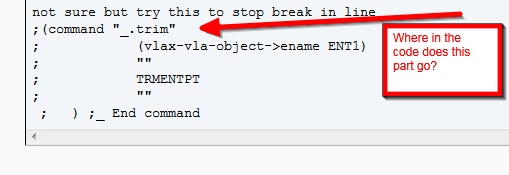

not sure but try this to stop break in line
;(command "_.trim"
;	     (vlax-vla-object->ename ENT1)
;	     TRMENTPT
;   ) ;_ End command
Thank you for your time, as I said before I am a little green when it comes to Lisp
I am attaching a few pictures that have questions when related to this Pipelabel Lisp and exactly where to insert these new Code Pieces
