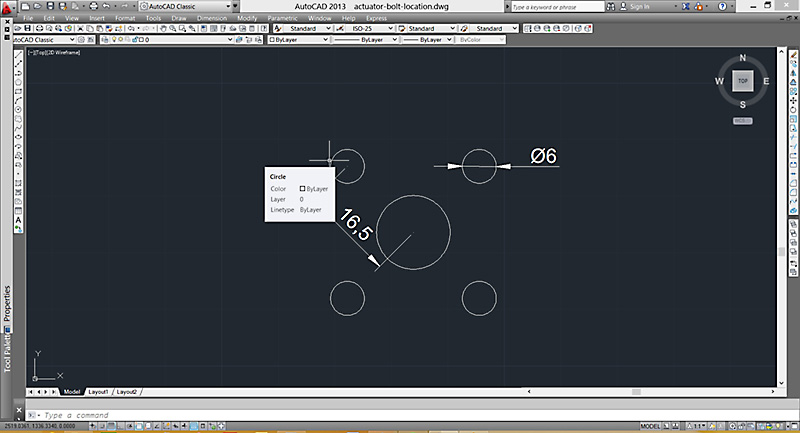

segmo85 Posted December 2, 2014 Share Posted December 2, 2014 (edited) Hello fellow CAD tutor Here I have a small project I’m working on. I’m new to all this cad design but I find it very enjoying, my cad skills is very basic but planning on improving. I’m currently using Auto CAD 2012. What I have problem with, is figuring out how to sketch this flange on cad so I can get it to a laser cut. Here I have uploaded some pictures and hopefully give you guys a good idea to what I would like to achieves. Pic 1 shows how the actuator fitted to flange, problem there is that the actuator rod is not pointing in the right direction, so I’m having this trouble getting full swing to actuator flap. So what I’ve done is by holding actuator with my hand it gives me a rough idea where the flange should sit, shown here in Pic 2. Now my big question is to how would I work out my angle? Position of holes? And so on. So I can create this flange on to sketch. If someone could give me some sort of advice and guidance to how I should take this approach will be much appreciate Edited December 5, 2014 by segmo85 Quote Link to comment Share on other sites More sharing options...

segmo85 Posted December 3, 2014 Author Share Posted December 3, 2014 Hey guys need help I can not print my sketch to real scale on A4 paper? I've tried setting plot and played with scale setting(1:1 etc) no luck. By the way I'm using cadiso template here I have an attached image but dunno how to attached dwg file. can anyone show me to what I'm doing wrong ? much appreciated James. Quote Link to comment Share on other sites More sharing options...
ReMark Posted December 3, 2014 Share Posted December 3, 2014 Click on the Go Advanced button > Click on Paperclip icon. Browse to your drawing. Upload it. Attach it to your post. Add a few words of text for good measure then click on Submit Reply. Quote Link to comment Share on other sites More sharing options...
SLW210 Posted December 3, 2014 Share Posted December 3, 2014 To attach a drawing file select Go Advanced at lower right of reply box, scroll down to Manage Attachments, browse to the file, select and upload. Quote Link to comment Share on other sites More sharing options...
segmo85 Posted December 3, 2014 Author Share Posted December 3, 2014 Thanks SLW210 and Remark actuator-bolt-location.dwg Quote Link to comment Share on other sites More sharing options...
