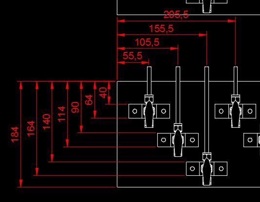

ReMark Posted December 4, 2014 Posted December 4, 2014 No problem dimensioning so far. An example... Yes, I know, it would never be dimensioned like this but I wanted to see how many dimensions could share a single corner. Is there something you'd like me to dimension specifically? Quote

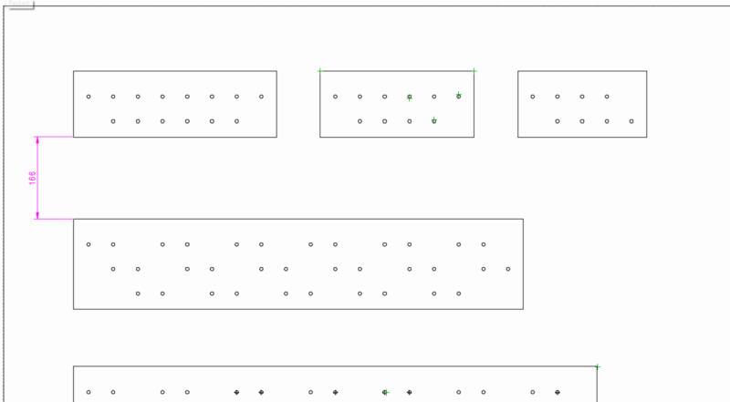

Buzza Posted December 4, 2014 Author Posted December 4, 2014 Yes, a "Drawing View" is an actual AutoCAD object... similar to a Viewport (which might be another route to explore and avoid the VIEWBASE headaches, especially since you're not showing any hidden lines in your projections anyway) For video/animation, I use Camtasia Studio, but two free alternatives are Camtasia's little brother Jing, and Autodesk has Screencast (formerly known as Chronicle) which is a actually a Plug-in for AutoCAD and a few other Autodesk products. -- youtube demo --> Thanks, that's useful to know. I used some gif maker in windows 7 but you can't add notes easily like Camtasia. This just happened to me, note where green snaps show. And, after adding the dimension I can't snap to those objects anymore. My gif uploads as a jpeg... ... they were bigger than 500kb that's why.. see below: . Quote

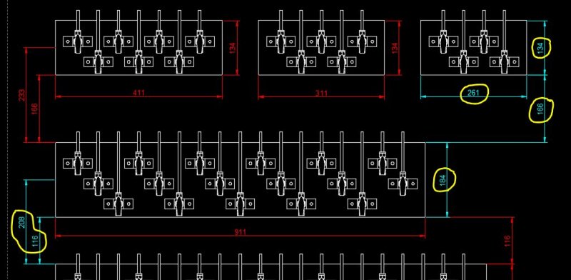

ReMark Posted December 4, 2014 Posted December 4, 2014 I'm baaaaaaaack. In the image below the cyan colored dimensions circled in yellow were the ones I deleted earlier (2.5 hrs. ago) then came back and added moments ago. Still no problem dimensioning the drawing. Don't know what to tell you at this point. Quote
ReMark Posted December 4, 2014 Posted December 4, 2014 Curious. When you are experiencing these types of problems are the features outlined in yellow above visible? Quote
