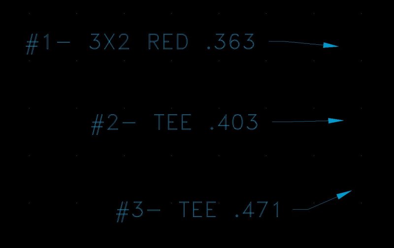

I am looking for a routine to automate what we already do. We have a routine that currently when we run the command it ask for "Select location on pipe" which then user selects a point where they want the leader to start.
After selecting the initial point the user then selects the "landing" point- the point where the number on a specific layer will appear.
It then asks the user to enter the number for point they are referencing. Once the user hits "1" then "enter". It automatically puts in that number on the layer specified in the code with a prefix(#) and a suffix (-). This gets the job done..
However, I am curious to see if there is a way we can automate the numbering some way so that maybe when the user starts the command it prompts [specify Starting Reference Point Number] so if the user wants to start with #44, he/she enters #44 then can begin putting in these points and it populate the numbers automatically instead of the user having to RERUN the command separately, having to specify the number then hit enter everytime.
Basically identical to Lee Macs Incremental Numbering Suite but with the option to pull leaders. Just seeing if there is anything out there I can use?
Thanks in advance.

tmelancon
I know this wont make much sense because there are other pieces that this code refers to but its really just data that its referring to and coordinates that draw a solid arrow with a line to become the leader. I am able to get the actual code to loop, however I am still having to type the numbers manually. Im stumped and I know I am so close to getting it. Let me know what you think...

Im so close to getting it. I just need it to remember the number that was entered here:
  (setq dpnum (getreal "\nEnter datapoint number (1.00-999.99): ")))
...and add 1 every time it runs, so it automatically increments +1 from whatever the previous number was. I may be overthinking too much. We are quite busy around here.
Any HELP is tremendously appreciated.

BIGAL
This is un tested
; change this line (setq dpnum (getreal "\nEnter datapoint number (1.00-999.99): "))
(getdpnum)

Even though it was error malformed list on input, I just noticed when I ran DTEST from the command line.. It prompted "Enter datapoint number (1.00-999.99):" but when I entered 1 it just showed "2" at the command line, I must have something in the wrong place.

tmelancon
This is basically what the code is used for... We run it to create data labels for specific points.

tmelancon
Hey BIGAL, I evaluated the code earlier today and deleted a redundancy, I believe thats what was messing up the entire routine. Just wanted to send and update to let you know if your reading this, I was able to get it.
Only small issue I am seeing now is a piece im going to have to look at tomorrow is that after user selects location and the code prompts for datapoint, when the user enters just say 1, it actually enters the number 2 in cad then loops and increments from there.

BIGAL
Sorry had 3 right parenthis on dpnum should be two. Changed example above
