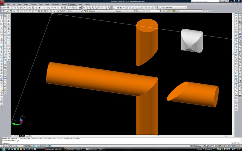

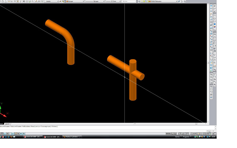

spursnutter Posted December 15, 2008 Author Posted December 15, 2008 If you imagine 2 tubes/cylinders touching each other on one end 90 degrees to one another i could use the interfere tool and slice them so there are mitred. I want to have a tube that has a 90 degree bend with a radius of, say, 70mm. I will try to post an example for you. Quote
spursnutter Posted December 15, 2008 Author Posted December 15, 2008 Draw it all in 2D then extrude. Yes I have done, but I was wondering if it is possible with using the fillet tool like you would with two lines or or solid box that you would want a radius on one edge. More curiosity than problem. I like to know as many ways of doing something. Can never know too much:wink: Quote
spursnutter Posted December 15, 2008 Author Posted December 15, 2008 Sample of what I was after Quote
MaxwellEdison Posted December 15, 2008 Posted December 15, 2008 If you are trying to make a pipe elbow, you can try unioning a sphere at the joint, or draw a polyline with the radius bend you want and extrude a circle using the polyline as a path. See my example below. Pipe Elbow.dwg Quote

spursnutter Posted December 15, 2008 Author Posted December 15, 2008 Is that a centerline radius or the radius of the interior corner? What are you doing for the outside corner (retaining the bevel)? Thats CL then for the external or internal radius you just Add or Minus half the diameter of the tube. Quote

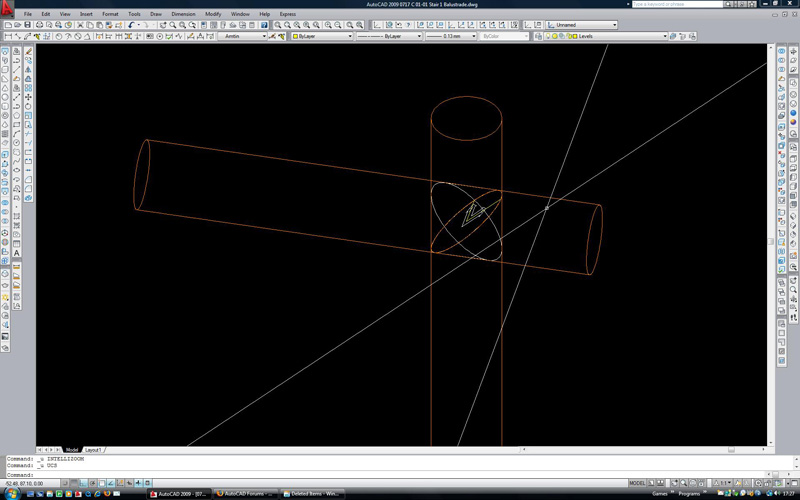

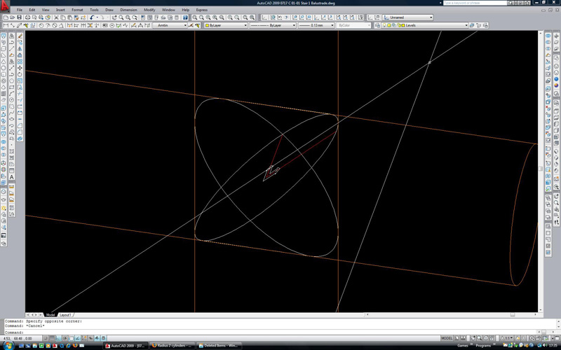

spursnutter Posted December 15, 2008 Author Posted December 15, 2008 First. Can you demonstrate the trick of using the Interfere and Slice commands to mitre a bend? Second. I don't think AutoCAD will understand what you're trying to do with the two cylinders. If you try to use the fillet command to construct the radius, after your pick(s), AutoCAD will tell you No fillet to be computed. Sorry I lost you there on the interfere and slice thingy. I mean to slice 2 tubes so you get a mitre you use the interfere tool and then the 3 point UCS icon and then slice. There is no radius that way just a mitred joint. Sorry if I didn't explain it very well. Quote
ReMark Posted December 15, 2008 Posted December 15, 2008 I still want to know just how you are using the Interfere command. Quote
spursnutter Posted December 15, 2008 Author Posted December 15, 2008 I still want to know just how you are using the Interfere command. I will try to explain. Take A look at the first image. I have my 2 intersecting cylinders with the other bit being the interfere bit that you leave on. Then you do a 3 point axis starting in the center and then top or bottom of the interefered oval and then the side. Once UCS is in right plane you then slice with XY co ordinates Quote
spursnutter Posted December 15, 2008 Author Posted December 15, 2008 The red lines are where you place the 3 point axis Quote
