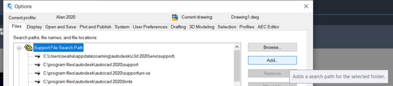

Open Notepad copy the lisp from here then paste into notepad. Save as say Dimtxtlink.lsp note the .lsp as file name not txt. You need to save some where you can find it. I suggest a directory like c:\Mylisps.
You can use Appload to load the program, a menu or toolbar to load, drag and drop from windows explorer.
To make life easier in Autocad you can use shorthand version for loading a lisp as Autocad knows where to look.
OPTIONS
FILES
Add the directory using ADD
Repeat for
Trusted paths
