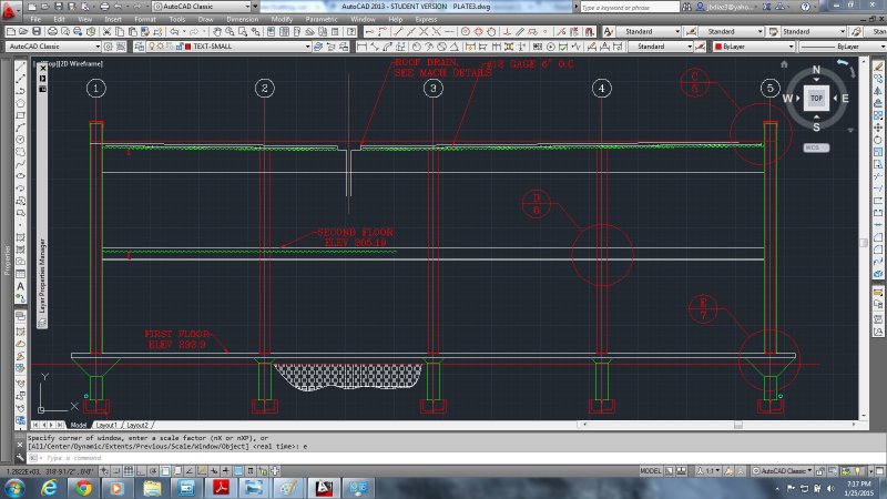

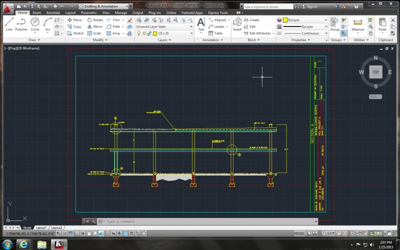

Here is what I got for plates 3 & 4. I think they could have put 4 on 3 and not done a separate plate. It was useless.
no where have i read where to put the J bolt. also the rebar is only on the footing. not the column above it.
here is what I have on plate 3
Page 11 last bullet tells you to put rebar in the pillar. Page 12 under the diagram has the bolt description. It looks like I have my details on the wrong side.
I see it now. i must have over looked it.

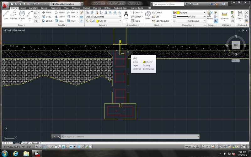

Vertical and horizontal rebar is placed in
the pillar similar to that shown in Problem 21-4, (page
45 in Structural Drafting with Basic Architectural
Applications). This rebar is also #6 rebar at 8″ OC. The
overlap of the rebar near the bottom of the pillar is
approximately 2″.
also on page 45 section A and B

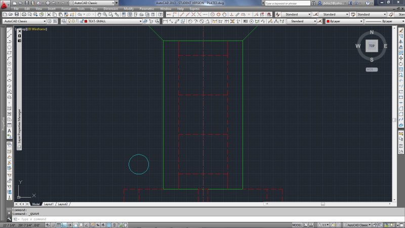

do a close up picture rose so I can have some idea what to draw here.

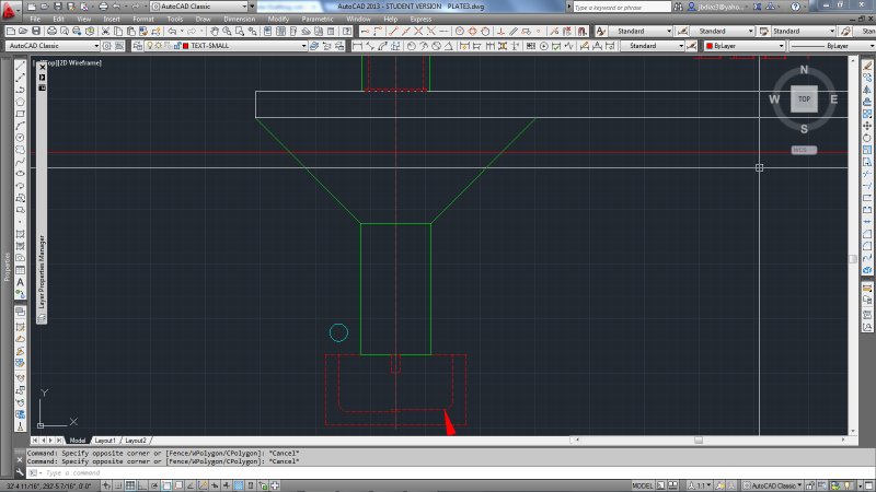

here is what I have so far on that
I'm not sure this is right so don't go by what I have.
Look at post #4. There is a drawing there that looks pretty accurate.
I did Remark posted it for me. let me see how to better do this.

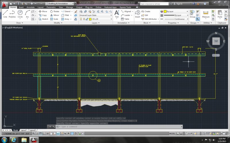

This is how im leaving it for grading. unless i hear better. my name is Jaime by the way rose. nice meeting you. how you do on the Olsen Village project?
It took me a while to figure it out but I got 100%
ROSE, where did you find the hatching for the concrete? or what did you use?
The hatch pattern is called AR-CONC and it comes standard in AutoCAD.
That is what I used ReMark. Do you have any feedback for me on what I've done so far?
