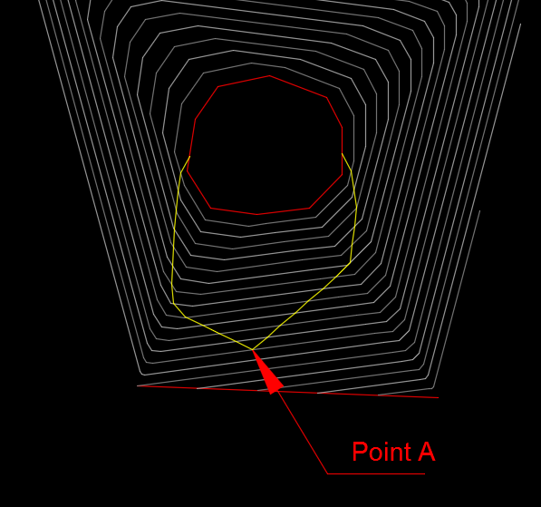

Jozi68 Posted January 29, 2015 Author Posted January 29, 2015 Thanx for all the advice. We tried getting the Dotsoft program, but they do not answer our emails, so they are not an option anymore. So I need to get this working. If I can't, I will probably not charge for it. I think my hourly rate is low enough to still make it feasible for a client. I've attached an image (can't get the drawing to upload?). If the user chooses 1% as the grade, and point A as the starting point, then the program should draw the 2 yellow lines. I hope this makes sense. Quote
Hippe013 Posted January 29, 2015 Posted January 29, 2015 Even with the image posted I still don't understand what you are trying to do. I appears to me (I'm guessing here) that the yellow lines are daylight lines for some grading at the 1% from point A to the red polyline. If I understand correctly more than just a point is needed for input. Either way, I'm going to go out on a limb here and say that what you may be trying to do can be done with the tools available through the API. If you are able to write up a detailed process of what you are trying to achieve then I would be willing to take the time to write the code. I only ask that you at least attempt to learn from the code. Quote
BIGAL Posted January 30, 2015 Posted January 30, 2015 If you create a planar sloping surface then it should work out the intersection points ie cut=fill. Quote
Jozi68 Posted January 30, 2015 Author Posted January 30, 2015 OK lets see. The 2 yellow lines have two very important characteristics: The are both draped on the surface, and they both have a slope of exactly 1% ALL the way up the hill. I.e we need to build a road up this hill, from the selected point (and at the selected grade, which is 1% for now). The cars can not handle anything less than 1%, and also not anything more than 1%. Normally there should be two possibilities. So the program needs to draw these two lines. I don't think a planar surface would work, as the direction of the lines change. So my thinking was to create 10m radius circle with the starting point as the center. Then drape it onto the surface. Then convert to 3dPoly line with 360 nodes. This was done very successfully by the code you've provided me with. The next step would be to find the node on the circle that would give a 1% slope (if connected to the center with a line). Then we need to draw another circle with this node as the center, and repeat the process to get another 1% line. Then repeat again, and again, and again until we reach the top of the hill. I hope this makes sense? Thank you for your willingness to help. Quote

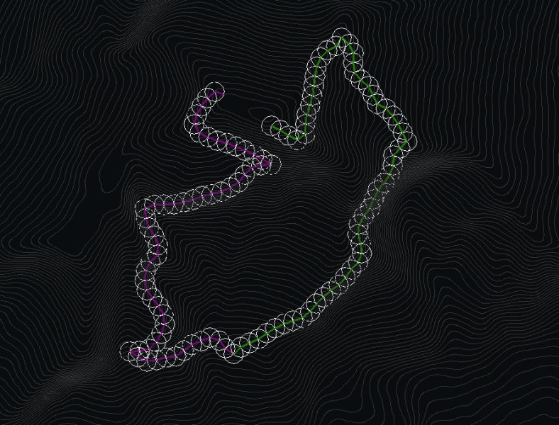

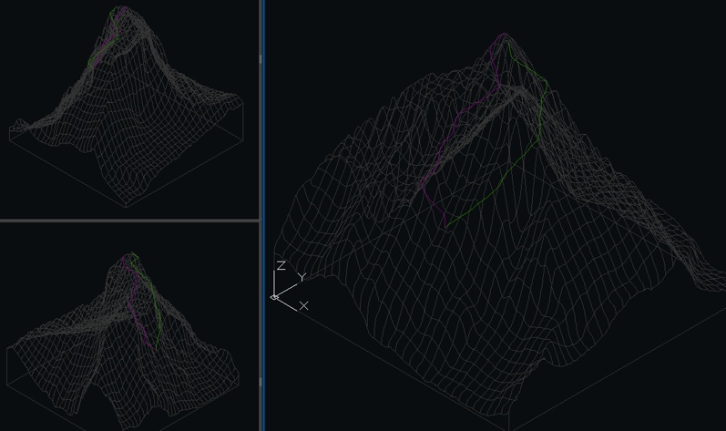

SEANT Posted January 31, 2015 Posted January 31, 2015 This post may help illustrate how I was envisioning the process. I have to agree; a 1% grade is rather shallow. Are you dealing with some sort of rail car? For my illustration, I used a Solid model (perhaps not overly accurate) of the Matterhorn. 1% was too shallow, so I used 100%.. Which is to say a Rise/Run of 1. Two different paths were plotted (manually, in this case) along South and SouthEasterly routes up the mountain. Some interesting things came to light, one being: The algorithm of intersecting circles can restrict the grade, but a check would need if the local terrain did not allow for the grade. As a confirmation that the two 3d Polylines maintain a point to point grade: In the attached, the polys start from the same point, and terminate at the same elevation - as a result, their lengths are the same. Matterhorn2.dwg Quote
SEANT Posted February 1, 2015 Posted February 1, 2015 Here are some Iso views of the model - just because they look pretty cool. Quote
