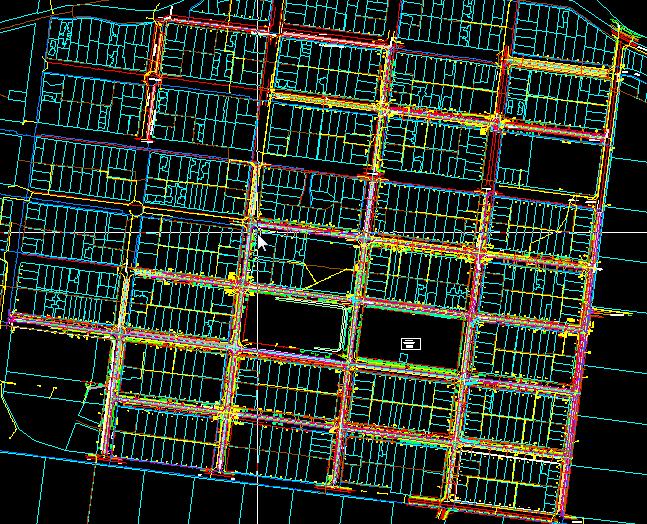

I will back my guys any day that they will be in the pub wednesday and you will be sweating come friday that its not finished. Here in Aus a typical subdivision say 50 lots all civil documentation, Drainage, sewer, roads, intersection design, if your not knocking out a sheet a day your doing something wrong. No way in the world could we do that with LT.
A retro project 11 streets 1 job. $4,000,000
