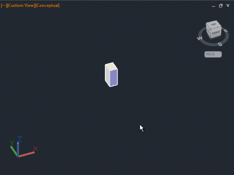

The Basepoint option will allow you to relocate the basepoint of the geometry (2D view) that Flatshot created.
Actually, it doesn't. That only established a temporary reference point for inserting the block.... the Basepoint remains where ever Flatshot decided it wanted it.
Not in the test I just ran. I moved the basepoint right onto the view I was inserting. Maybe your version works differently?
I'd be happy to be proven wrong, but FLATSHOT is a tool I've used frequently for many years, and I've never been able to change the basepoint of the block during the command.
We've had this discussion before about commands working differently even though we both use the same version.
I just repeated the exercise I ran the first time and I am able to pick a new basepoint on the flatshot (2D block) I am inserting. Just to be clear...I am not picking on the 3D model.
same here. very annoying as i use it a lot.
I think there's a miscommunication. I've seen too many threads and too many Autodesk sponsored tutorials to believe you can change the defined basepoint during FLATSHOT command. When inserting the Flatshot block, it's actually the command line version of the INSERT Command, where the user can specify a "basepoint" but it doesn't change the actual Basepoint of the block, it only creates a temporary reference basepoint for placing the block/xref. For that matter, COPY and MOVE command also prompt the user for a "basepoint" but again, it's a temporary reference point that exists only as long as the command is active.
Third and final test.
Flatshot, Enter > Create, Enter > Specify insertion point or [basepoint/Scale/X/Y/Z/Rotate]: B, Enter. STOP! Immediately after hitting the Enter key the crosshairs can be repositioned. AutoCAD prompts: FLATSHOT Specify base point: and I can pick on any part of the block geometry itself and move it where I want on the screen.
OK, do that, then Select the block and post a screenshot that shows the Basepoint Grip.
Why would it matter at this point? The block has been inserted.
Don't think that really needs an answer, as it's probably covered in the first paragraph of every piece of reference material ever written about the creation of Blocks.
I gave the OP a way of controlling the basepoint upon insertion of the block. If that isn't what he wanted fine. Makes no difference to me. BTW....you don't need a grip to move a block. As a matter of fact if grips were that important maybe they should have included their use a lot earlier in AutoCAD's development. I wonder how users got anything done before their introduction? I guess the CAD world was in limbo up to that point.:lol:
