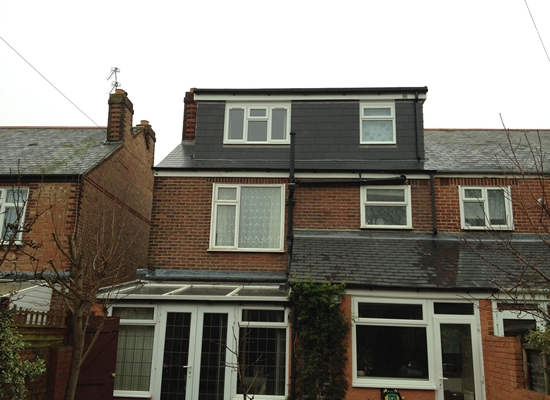

sparkyuk Posted February 23, 2015 Posted February 23, 2015 Hello All her in doors has been watching a improve your house type program on UK TV and saw them building a dormer in the roof, my question is how much would a set of drawings including any work by structural engineer cost please, the dormer would be about 5.5 mts across and 5mts from ridge line and only one room with stairs and looking like below if it helps Quote

danellis Posted February 24, 2015 Posted February 24, 2015 What specifically does your local building department require in the way of drawings for something like what you propose? According to the Planning Portal extensions guide here: http://www.planningportal.gov.uk/uploads/miniguides/lofts/Lofts.pdf at that size (27.5m2) Planning Permission would be required, and it would be irrespective of size if the dormer were facing the street). The fee for an householder Planning Application is £172. You would also require Building Regulations approval, which a quick google suggests is £400-£500. You need to decide whether you'd want to manage these applications yourself (only paying for the drawings) or whether the person you employ should manage them for you. I'm sure this would affect the fees they'd charge! The drawings required for the Planning Application would be: Location plan showing your home in the context of it's neighbourhood. Block plan at a larger scale, showing just your home. Before and after floor plans. Before and after elevations. I'd have to check for Building Regs but they'd essentially need the drawings necessary to build the extension itself, more detailed floor plans, sections, along with engineering calculations to prove your existing structure would be up to the job of holding the extra weight up. HTH dJE Quote
sparkyuk Posted February 24, 2015 Author Posted February 24, 2015 (edited) Our building control department tell me that they do not need to see any drawings for this type of work as planning is not required if it is under 40 cubic metres for terraced houses, but they do check the work as its being constructed to make sure it complies with the building regulations, they tell me I just need to employ a building contractor who carries out this sort of work all the time as they will know the correct way of construction a dormer and will sort out what steel need to be added etc. I wanted full drawings for my peace of mind so that I can see what and how it is going to be carried out and that I will avoid any trouble down the line, and that any quote I get is for the full job and non of " Oh that wasn't allowed for etc etc costs added" Sorry Danellis I didn't answer your post was on the phone while typing above. Yes you right 5.5 x 5 x 2.4 = 66 cubic metres i believe my maths is correct so I would have to lower the size of it to about 4x4x2.4 to not need planning correct? And thank you for the detail info you have supplied Edited February 24, 2015 by sparkyuk didnt see danellis post Quote

Glen1980 Posted February 25, 2015 Posted February 25, 2015 I've just asked the guy at work who does lots of private work and he says a grand all in for planning, regs and structural calcs, drawings only all submissions are paid for by his client. Quote
sparkyuk Posted February 25, 2015 Author Posted February 25, 2015 Thanks Glen that is about what I Have been told by some one else and I was thinking it sounder a lot but it isn't, and I see it includes the structural calcs as well. Looks like if her in doors wants the full size 5.5mt x 5 mt dormer we will have to get planning so just a case of finding someone local to do the drawings for me. Quote
