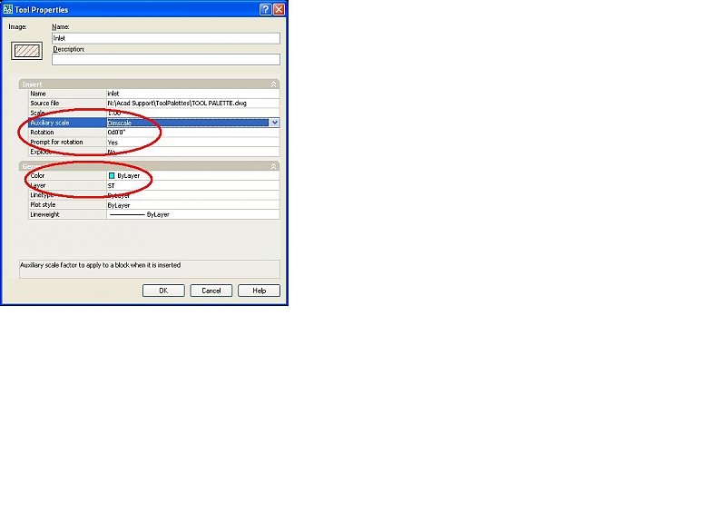

I have a dwg that contains all the blocks I want on the toolpalette; drag and drop (using rt mouse button) the block onto the toolpalette. Rt-clk on the toolpalette icon for the block, select Properties, you can designate scale, auxillary scale, layer. (see attached).
