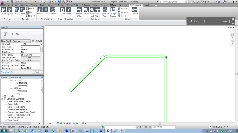

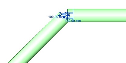

humbertoquaresma Posted March 16, 2015 Share Posted March 16, 2015 when I begin to trace the path of sewage and when I need to change direction at 45 degrees or 90 degrees the revit does not put the correct elbows, why? Someone help me? Thank you in advance Quote Link to comment Share on other sites More sharing options...
tzframpton Posted March 16, 2015 Share Posted March 16, 2015 Can you upload the image correctly so I can view the screenshot you have? What Elbow Family are you using? Quote Link to comment Share on other sites More sharing options...

humbertoquaresma Posted March 16, 2015 Author Share Posted March 16, 2015 thank you Tannar its my first time in this forum and I am not used to it...but I think now I did upload the image..could you help me? Quote Link to comment Share on other sites More sharing options...
tzframpton Posted March 16, 2015 Share Posted March 16, 2015 No problem. First off you do not have any Routing Preferences set with the proper Elbow Family. You may even be missing a Lookup Table for the elbow. Did you start from a non-MEP Template where this stuff is usually predefined? Quote Link to comment Share on other sites More sharing options...
