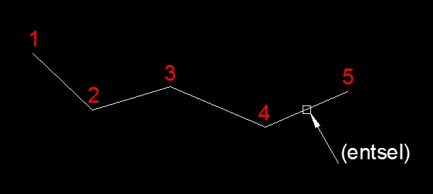

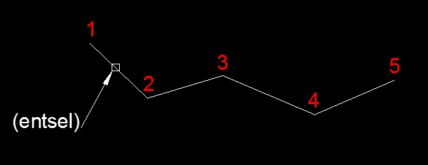

Hi.
I choose the LWPOLYLINE using a ENTSEL function.
Using code.
(setq cor (vlax-get (vlax-ename->vla-object (car (entsel))) 'coordinates))
Always get.
'(1x 1y 2x 2y 3x 3y ...)
How to get a list of coordinates, depending on which side you choose an LWPOLYLINE?
Example:
Select segment on side 1-2.
Get:
Select segment on side 4-5.
Get:
'(5x 5y 4x 4y 3x 3y ...)
