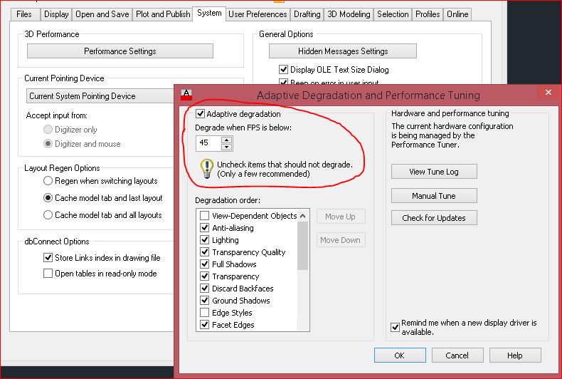

You might want to consider using ADAPTIVE DEGRADATION, which you can set to help keep your fps speed up, by deprioritizing functions which you don't typically need. You can access it on the SYSTEM tab in OPTIONS, click on the 3D PERFORMANCE settings button.
Or you can clean up the drawing first followed by moving the geometry closer to 0,0.
