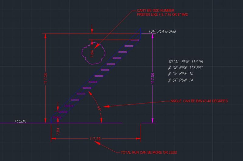

Appologize if i posted in the wrong section, it gets more into math calculation. what is want to learn from your guy is that, when i calculate the riser dims, instead of getting the odd number like i had riser=7.84 in or 7.35 in (16 risers), what do i need to do if i want to riser to be some nice and even number like 7.75" (prefer) or 7.5 or 8 inces?. i just don't like 7.84 in since it is hard for the guys who will fabricate this stair. i try to make their life much easier. In this case, total riser is fix but i can increase the total run or angle can be more or less. i included CAD dwg. appreciate any inputs. Thanks
Note: Typo on the image, total run is 117.56 in

Hi Dadgad, first of all this is not residential, it's outdoor, i want to have a stair that go up to the platform. Stair will be made of stainless steel (the stair stringers will be bend from sheet metal), the steps will be Chemgrate with handrails. I acually measured the total riser from the top of the platform to the end of the 117.56" of total run toward the left, i used horizontal reference line as datum because the floor is sloped. i like to design where i can get riser is 7.75" but the angle does not have to be 45 degree.

ChecK your NBC minimum risers and threads dims are given of course one can build them differently but when injuries occurs because of it you will face a legal pursuit you will be hit hard.
Not sure where you are but here you have a tolerance on the rise/run so maybe you can make say the 1st step a fraction different it would have to be very little so from a walking point of view you dont notice it.
absolutely, ealier i had all figured out for riser of 7.75" but the last step to the floor is great than 9" so this is not acceptable, i always concern about rule and regulation that is why i don't go more than 8". Location US.

I would opt for a 10" to 12" thread and 1" overhang with 9"-12" run
with an 6" -9" rise
with an 6" -9" rise
What is my total run would be to meet that?
It all depends on the rise height and threads you will use
It doesn't matter what the angle is, you have a rise of 117.56 and a defined number of steps, the distance between will always be 7.84.

No such thing as even numbers, numbers will always be the results of the total height divided by the number of steps therefore if the division is done with whatever number result will be what it will be period if total height is even divide by even the result will be even.

lower the landing .44 inches that way you have an even number to divide.
or use metric @199mm each rise and height as is at 117.56"
The guys in the shop shouldn't have any problem with measurements like 7.84 or 7.35 if they are professionals. We do this kind of thing all the time in our fabrication shop and the welders make it work.
I've done a small number of stairs and always pulled the running measurement from a fixed point at the bottom. Give your guys running dimensions from the bottom landing or anchor point to the top of each tread or something similar. Don't try to index each tread off the one below. Errors multiply fast that way.
Seems some companies must be using apprentice welders. We indicate the fixed height between stair treads once on our fabrication drawings. Amazingly enough our welders know what this means. No running heights from a fixed point or multiple instances of the same height from step-to-step, etc., etc., etc.
sorry i shouldn't say "Even" number, i should say some easy fraction that is easy to work with
.44"?? how did you get that Robp?
You have to ask? Add 117.56 plus 0.44 and what do you get? Answer: a nice even number. Now divide that number by the number of risers (16). What do you get? Your welders will reward you with a big sloppy kiss for making their lives so good. Everyone goes home happy; well maybe not you. How does one explain being kissed by a group of welders?
hahaha, you just made my day Remark. By doing this my last step to the landing is .438" different than the rest, i will have to check with the stardard safety requirement.
