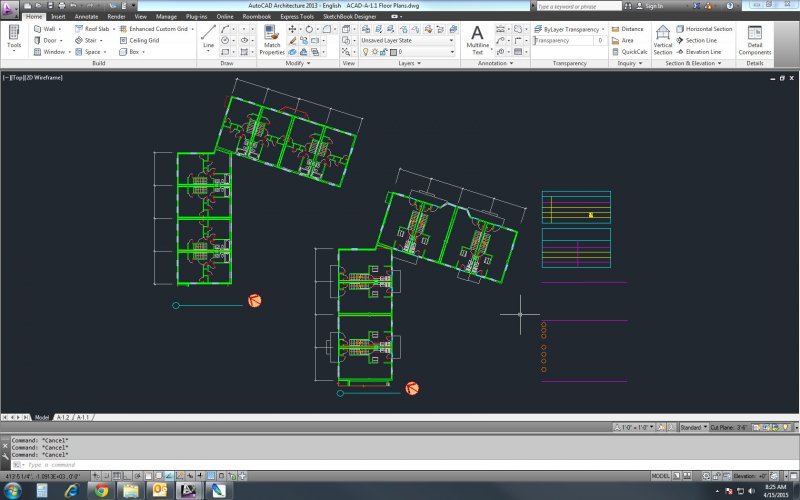

gfarrell80 Posted April 14, 2015 Posted April 14, 2015 I'm going nuts here. This thread was pretty close to the problem but did not solve it: http://www.cadtutor.net/forum/showthread.php?71787-Missing-Text I've received several drawing files from another architect. AutoCAD 2013. At my workstation the text annotation is not visible in either model space or the layout tabs. At my co-workers stations they can open the file and all the text is visible per normal. Having them save to older format or .dxf format and then having me open the file does nothing, the objects remain invisible. Turning all layers on and checking frozen in viewports gets me nothing. QTEXTMODE = 1 and regen gets me nothing. ANNOALLVISIBLE = 1 and regen gets me nothing. However, I can use the qselect command to select by layer the annotation objects I cannot select any other way. Changing their color or switching their layer does not make them visible. Window selecting does not grab anything. Other 2013 .dwg files I'm working on I can open and the text appears normally to me. Freaking bizarre and driving me literally bonkers. Quote

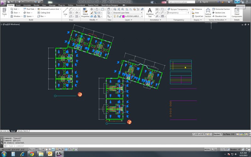

gfarrell80 Posted April 15, 2015 Author Posted April 15, 2015 Thanks. Here we go - attached a stripped version. Floor Plans.dwg I couldn't see the "Go Advanced" button, but here are the screen caps attached: Any insight is appreciated! It is looking like I might have to swap workstations for a day and a half with a co-worker to do the editing if I can't get a fix. First screencap is just modelspace, 2nd screen cap is some of the ghost text selected via qselect. I tried copy/pasting it into a different CAD file, but it remains ghosted. I'm using the same font support file as my other co-workers. Quote
nestly Posted April 15, 2015 Posted April 15, 2015 When I open the drawing using AutoCAD 2013 (vanilla AutoCAD, not ACA) , I'm seeing box placeholders on A-Room Labels layer. QTEXT = OFF followed by Regen restores the Mtexts. Your screencap seems not to even display the text placeholders, is that correct? Quote

gfarrell80 Posted April 15, 2015 Author Posted April 15, 2015 When I open the drawing using AutoCAD 2013 (vanilla AutoCAD, not ACA) , I'm seeing box placeholders on A-Room Labels layer. QTEXT = OFF followed by Regen restores the Mtexts. Your screencap seems not to even display the text placeholders, is that correct? Correct, I am not even seeing box placeholders. QTEXT = OFF and regen does not restore the text. QTEXT was 'on' though. Quote
nestly Posted April 15, 2015 Posted April 15, 2015 I think Rob had it right. The drawing is using a non-standard font. I don't have that particular Font either, so FONTALT is substituting simplex.shx. Maybe you don't have an alternate font set (FONTALT) and/or your font mapping file (acad.fmp) is mapped to a non-existing font? About Substituting Fonts Quote
gfarrell80 Posted April 15, 2015 Author Posted April 15, 2015 I think you're right, it has to be a font thing. I'll check into the substituting fonts link and let you know how it goes. Thanks! Quote
gfarrell80 Posted April 15, 2015 Author Posted April 15, 2015 Success, thank you nestly and all. Messing around with the substitute fonts has gotten me there. phew! Quote
