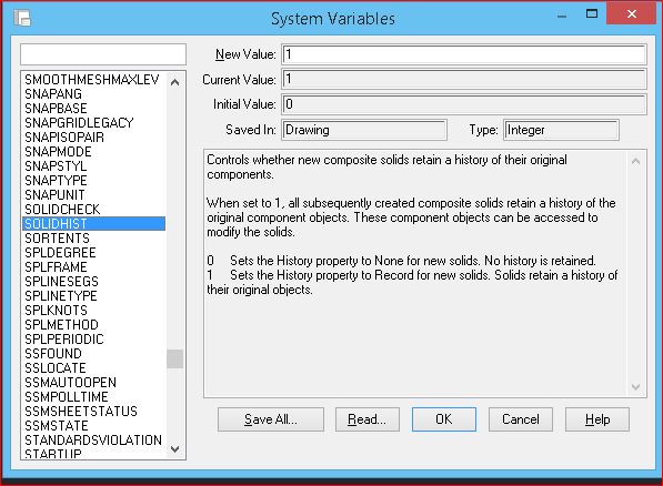

Interesting. Why does a very large structural channel appear when the car is selected?
After starting the Fillet command and picking the car.

This is displaying when the solid is selected because you have SOLIDHISTORY turned on.
