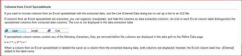

Dadgad Posted May 5, 2015 Posted May 5, 2015 Dadgad - I actually have a program that I wrote in excel that did this pretty well for CAD LT for the company I work for. Is there a chance that writing a Autolisp might but able to overcome this issue? Any other ideas would be greatly appreciated as well! I should think (highly speculative from an il-lisperate) that it probably could. As frustrating as it is, does the excel program you wrote work with your new Autocad Mechanical? I am pretty sure you won't be able to do it within the data extraction function, unless you opt for a DATA LINK from excel, as described in the screenshot. Quote

Dadgad Posted May 5, 2015 Posted May 5, 2015 Not having the Data Extraction facility, my comments are purely theoretical.In a spreadsheet or table, the data always has its full value, regardless of the visible precision. Unless you operate on that data with a formula, you will never get the result that you are looking for. Have you inserted a Formula column and what formula have you used in that formula column? I couldn't figure out how to write a formula which would change (as opposed to display) it to the nearest whole number, figured that might be handled in excel, and that column brought back into the data extraction table with External Data Link, as described in the last screenshot. Quote
