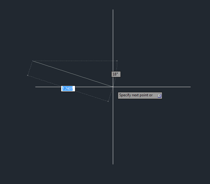

Cad64
Automatic dimensioning? :unsure:
Are you talking about what's shown in the screenshot below? If so, just hit F12 to turn off dynamic input.

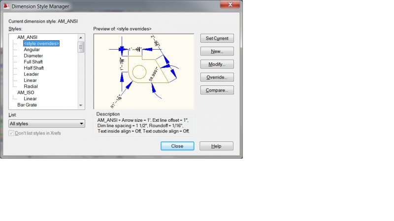

Dadgad
Welcome to CADTutor. :)
I have never used Autocad Mechanical, but am nontheless intrigued by this problem.
Could you provide a screenshot of your DIMSTYLE Manager?
I have not taken the time on a beautiful Sunday afternoon to click on the links which Cad was kind enough to supply, nor do I plan to, as I have other things to do.
But I would appeciate a glimpse of your dimstyle manager.

JohnnyDean
DIMSTYLE MENU.jpgDADGAD: Thanks for your considerations. I get an error message "Unknown Command" when trying for the express tool "SYSVDLG". It's raining on my Sunday afternoon. You have my dimstyle menu. Thanks for trying.

Dadgad
Create yourself a NEW dimstyle.
You will need to pick an existing one as the jump off point, from which you can change settings to suit for your NEW dimstyle.
I suggest you choose AM_ISO, as it is the least defined, without a whole bunch of CHILD dimstyles.
Come to think of it, first things first. :|
Just change your current dimstyle to be AM_ISO, and take that around the block.
If you are comfortable with that dimstyle, and if it is appropriate, after having given it some thought and really checked it out,
you MIGHT WANT to select all the dimensions in your drawing and change the dimstyle to it.
You might also want to save a copy of your drawing, and monkey around with the dimensions on it, for due diligence.

JohnnyDean
Dadgad: YES, YES! I changed my dimstyle setting to AM_ISO and had near instant results. My dimensioning had gone back to the system I have utilized for the last 10 years. Thank you as you were the only person to understand what had happened.
