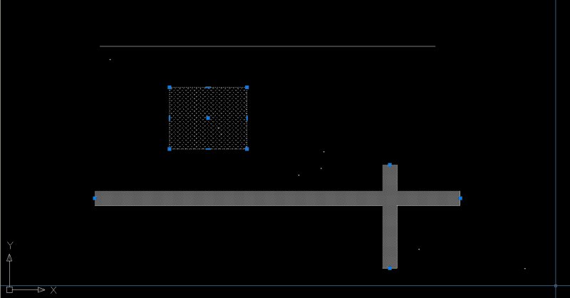

Is there a system variable to control the display of polyline widths?
Due to my work, there is a bunch of existing polylines with different widths that i need to adjust (but not the width) so I need to toggle them on/off visually.
If no, is there is a roundabout way?
Thanks

Well. actually this is how the work goes.
1)I will be adjusting some THICK polyline, in relation with THIN polylines
2) To adjust those THICK lines, because it is too thick it covers the THIN polylines & i cannot see them.
Hence i need a way to temporary visually have the THICK polylines "thin" so that I can see what i am doing in relation with the THIN polyline.
3)After adjusting the THICK polylines (that is visually "thin" now), i than want the THICK polylines back to its original thick widths.
This THICK polylines is all over the drawings so I need to adjust them & need an even quicker way to "toggle" those THICK polylines ON & OFF.
Hope you get what i mean.

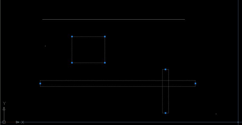

There is no sys var wich shows you polylines with differents width > 0 as lines.
But if you have problem with the filling try to set
FILLMODE = 0,
all plines with width>0 will showed like rectangles (pay attention, all fillings will turned off, even hatches).
then reset FILLMODE = 1
I forgot...use REGEN after switching 1 to 0 end vice versa.

Great point - completely forgot about FILLMODE! Haha
Building on your apt post:
(defun c:FAT ()
 (setvar 'fillmode 1)
 (command "._regen")
(defun c:THIN ()
 (setvar 'fillmode 0)
 (command "._regen")
Fillmode=1
[attach]54203[/attach]
fillmode=0
[attach]54204[/attach]

Thanks Marmo. It works. I am able to work with this. :D
Thanks Blackbox for the LISP. I prefer using macro script oo i wrote this for myself instead. :P
^C^CFILLMODE;1;REGEN;
^C^CFILLMODE;0;REGEN;
