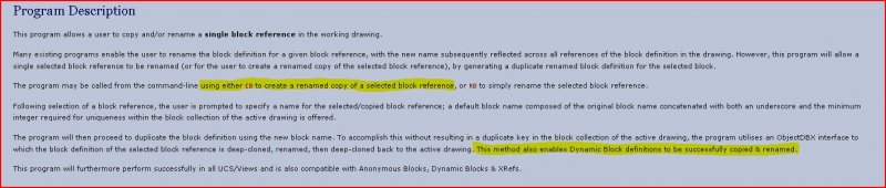

Thanks guys I already use Lee's RB command but does anyone have a way to make a block static on a certain visibility state?
Have you tried the CB option in Lee's lisp, from the description, it sounds like it may be able to do it?
Thanks for your help guys that Lee's lisp doesn't make the static block. Any other ideas?
When in doubt, check Lee Mac out. :)
