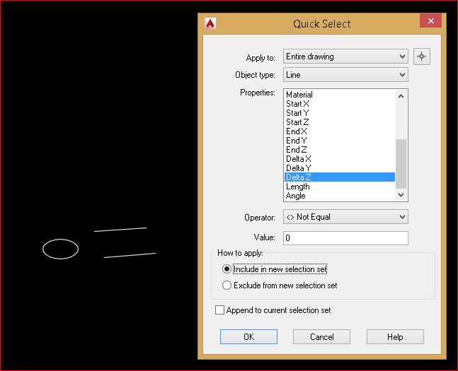

Guitte Posted June 8, 2015 Posted June 8, 2015 Hi, Im struggling to find a solution and the right terminology to explain. Most of the drawings, that was started by others or been modified by them, i find that most of the time, the UCS origin is not set to 0,0,0 or a few lines are not set to "0" on the Z-Axis when going to properties. Can this happen because some colleagues in the company have ACAD LT 2D and some have full version ACAD, that can change or influence the Z-Axis on the specific drawing? Someone told me to use "flat pattern", find that it doesn't exist in ACAD LT only in the full version. Is there a way to overcome this problem or an alternative way? Many thanks for any advice. Quote

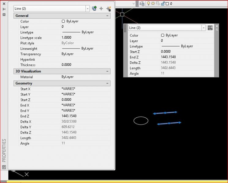

Dadgad Posted June 8, 2015 Posted June 8, 2015 (edited) That is telling you that 261 of the items were ineligible for this approach, as it only works on elevations of entities which are parallel to your current plane. They are not flat, if you will, which is worse than if their elevations only are incorrect. There are lots of threads on the forum about this problem. I will look for one for you, but because you are using LT, lisp solutions are not an option. In that case you could select everything and set the START Z elevation & the END Z elevations to 0, as shown in the screenshot, in your Quick Properties palette, or in your PROPERTIES. Just click into either of the END Z values and set to 0, and that will flatten all those crooked (meaning Delta Z not equal to zero) lines. You don't really need to use Quick Select to define them as a selection set, you could just select all of the lines instead, but it is an option if you need to. Edited June 8, 2015 by Dadgad Quote

Dadgad Posted June 8, 2015 Posted June 8, 2015 Just do a crossing window of the whole drawing, then select LINES, and reset both the START Z & END Z values to zero, all at once, and you are done. Quote

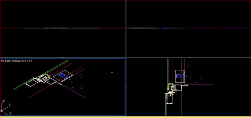

Guitte Posted June 8, 2015 Author Posted June 8, 2015 Sorry Dadgad, It didnt work. Please see the link. We have tried End, Start and Delta Z. The green and red vertical lines did not change. This is the drawing giving hassle. 3http://https://www.dropbox.com/s/3floeuxbqkig0xk/Drawing2.dwg?dl=0 Quote

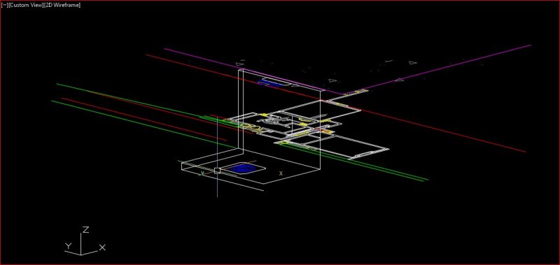

Guitte Posted June 8, 2015 Author Posted June 8, 2015 I think one reason for the z-axis being incorrect, might be that we copy the details from other drawings that were never cleaned. What bothers me is that each elevation on each job is different, no copying will take place. But when someone else in the company is opening your drawing make some changes, by the time the architect returns with comments about the elevation needs to be changed, you might find that the elevation lines are not set on "0" on the z-axis (sometimes not all the elevations are affected in the same drawing). Might it be that colleagues using ACAD 3D somehow have an influence on some lines or perhaps the whole drawing? Quote
Dadgad Posted June 8, 2015 Posted June 8, 2015 Now that I see the drawing, things look a bit different. Somebody who worked on this drawing has drawn some elements in 3D. They are not modeled in 3D, but drawn so as to represent edges of 3D elements, some of those are perpendicular to the current UCS. They are not crooked, which was how I took your earlier descriptions of the varying z values. I am able to flatten everything using the process I described earlier though. You don't need to enter the DELTA Z value as zero, just enter zero into the Start Z & End Z, and the software will calculate the Delta Z value as 0. Quote
