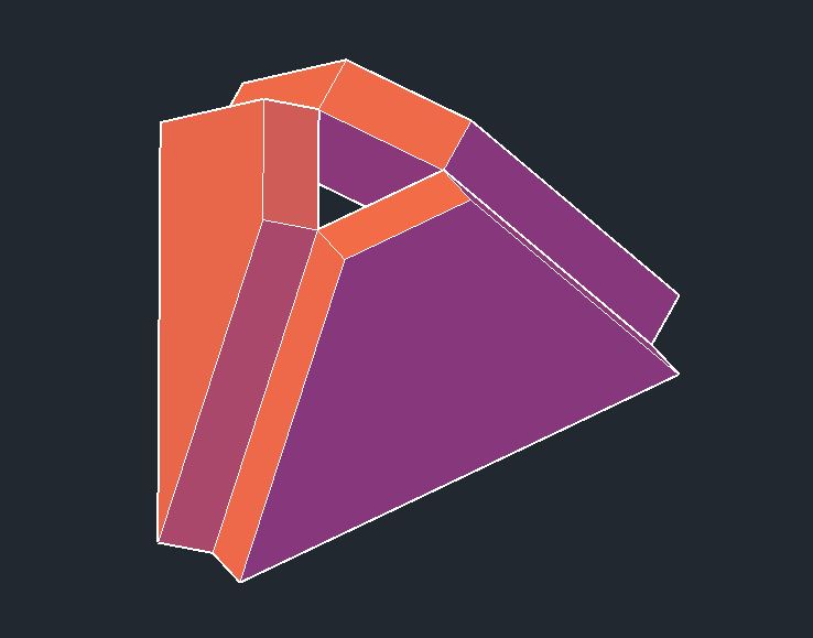

Jordan27 Posted June 8, 2015 Posted June 8, 2015 Hey Guys & Girls, This is probably a simple problem but can someone please help me with aligning the 3 objects in the attached 3d_align_test.dxf I want the points to be touching at the top, not just the bottoms. To form a pyramid. Using the 3DALIGN tool I can get 2 sides attached but get stuck trying to get all 3 together. Any help would be awesome! Thanks very much. J3d_align_test.dxf Quote
ReMark Posted June 8, 2015 Posted June 8, 2015 The bottom of your pyramid won't be flat though. Is that acceptable? This is what I came up with.... Quote
ReMark Posted June 8, 2015 Posted June 8, 2015 I apologize for the double image above. Not sure what is happening. If you make one of the 3D objects at the correct angle (since it must tilt inward) then do a polar array you'll have what you are looking for. There is at least one or two other ways to achieve the same result but they would involve a little more work. Quote
Jordan27 Posted June 8, 2015 Author Posted June 8, 2015 Thanks ReMark this is what I am looking for! How did you know what angle one would tilt inward at though? Quote
Jordan27 Posted June 8, 2015 Author Posted June 8, 2015 I need to do this with 3 different 3D objects (all same size/shape but have different holes in the middle of them) for a work project - once you have done a polar array are you able to find out the angle they sit on, then replace 2 of the objects? Thanks for the help! Quote

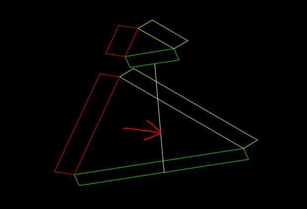

ReMark Posted June 8, 2015 Posted June 8, 2015 (edited) I used some 2D geometry to figure out the angle. The polar array should be done using one correctly tilted 3D object. Edited June 8, 2015 by ReMark Quote
Jordan27 Posted June 8, 2015 Author Posted June 8, 2015 Are you able to explain the 2D geometry at all please ?? This would come in really useful! Thanks ReMark! Quote
ReMark Posted June 9, 2015 Posted June 9, 2015 This should be self-explanatory. When you check the properties of the white line you'll have the angle you need. Quote
ReMark Posted June 9, 2015 Posted June 9, 2015 What seems to be the problem? The rectangles represent the top/bottom of your truncated triangles set at the proper height. Merely draw a line between a pair of them. Quote

Jordan27 Posted June 10, 2015 Author Posted June 10, 2015 Still having a little trouble sorry... In the picture above, how did you know what the 'proper height' was they would be once on the correct angle? How did you know what the correct angle was in the first place? How do I do this with 3 parts which have different holes etc in the middle of them? When you did a polar array of one part, what was the centre point you are arraying them around? Maybe are you able to explain any other ways of putting these 3 objects together...? If you could post a dxf of your initial 2D geometry / completed 3D workings that would be awesome, might help me get it a bit better. Thanks!!! Quote
ReMark Posted June 10, 2015 Posted June 10, 2015 (edited) I cannot attach any files at this time. Edited June 11, 2015 by ReMark Quote
