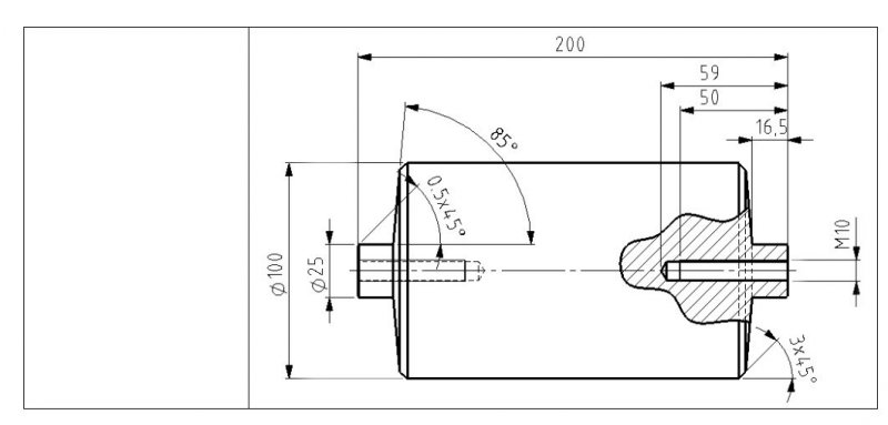

indigo Posted June 22, 2015 Share Posted June 22, 2015 Hi, I'm a little confused with the 85 degrees on the drawing..is it the fillet angle.. and also the 0.5 x 45degrees is it the chamfer on the smaller cylinder ? Thanks.. Quote Link to comment Share on other sites More sharing options...
Tiger Posted June 22, 2015 Share Posted June 22, 2015 the 85-degrees angle should be the sligthly off-straight line - the farthest left line of the big cylinder if you get where I am pointing. (yes, I am pointing at my screen - not my fault you guys can't see where I am pointing...) the 0.5x45degrees is the chamfer on the top on the small cylinder. 0.5 is the width and 45degrees is the angle of the chamfer if I remember my drafting classes correctly. Quote Link to comment Share on other sites More sharing options...
indigo Posted June 22, 2015 Author Share Posted June 22, 2015 Hi @Tiger, Does this mean I have to fillet the sides of the big cylinder? Thanks .. Quote Link to comment Share on other sites More sharing options...
Tiger Posted June 22, 2015 Share Posted June 22, 2015 Weeell.... yeah. Sort of I guess. The sides (or the top and bottom I would say, but sides as we see the cylinder in the picture) of the big cylinder are not straight up-and-down - they are two chamfers: one with 3x45degrees first and the the larger one that is on a 85degree angle from the centerline of the cylinder. Quote Link to comment Share on other sites More sharing options...
indigo Posted June 22, 2015 Author Share Posted June 22, 2015 Hi @Tiger, Thank you very much.. I got it Quote Link to comment Share on other sites More sharing options...
