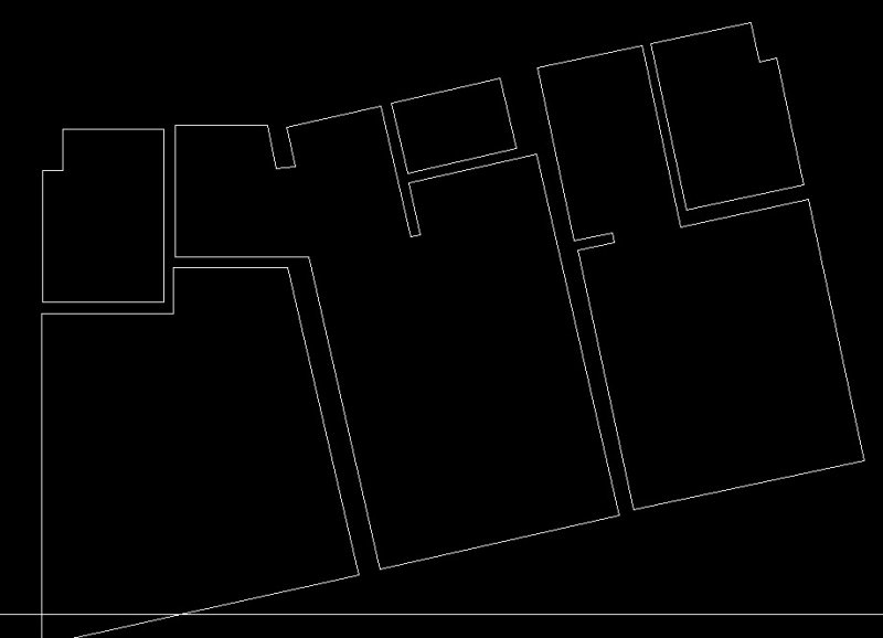

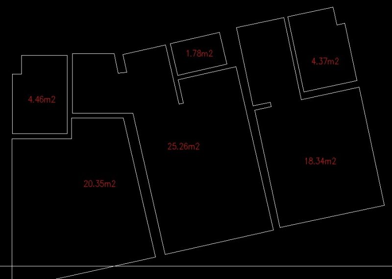

Is it possible to add some text above area ? For example
Room Room
12.35m2 2.14m2
Put an example picture or something to give me a better understanding of what you want.

In simple way, change this line:
(cons 1 (strcat [color="blue"]"ROOM" " "[/color] (rtos (vlax-curve-getArea x) 2 BRDM) "m2"))
Or ... ;)
(cons 1 (strcat [color="blue"]"ROOM "[/color] (rtos (vlax-curve-getArea x) 2 BRDM) "m2"))
Thank you very much for the quick response and the help, you're the best!

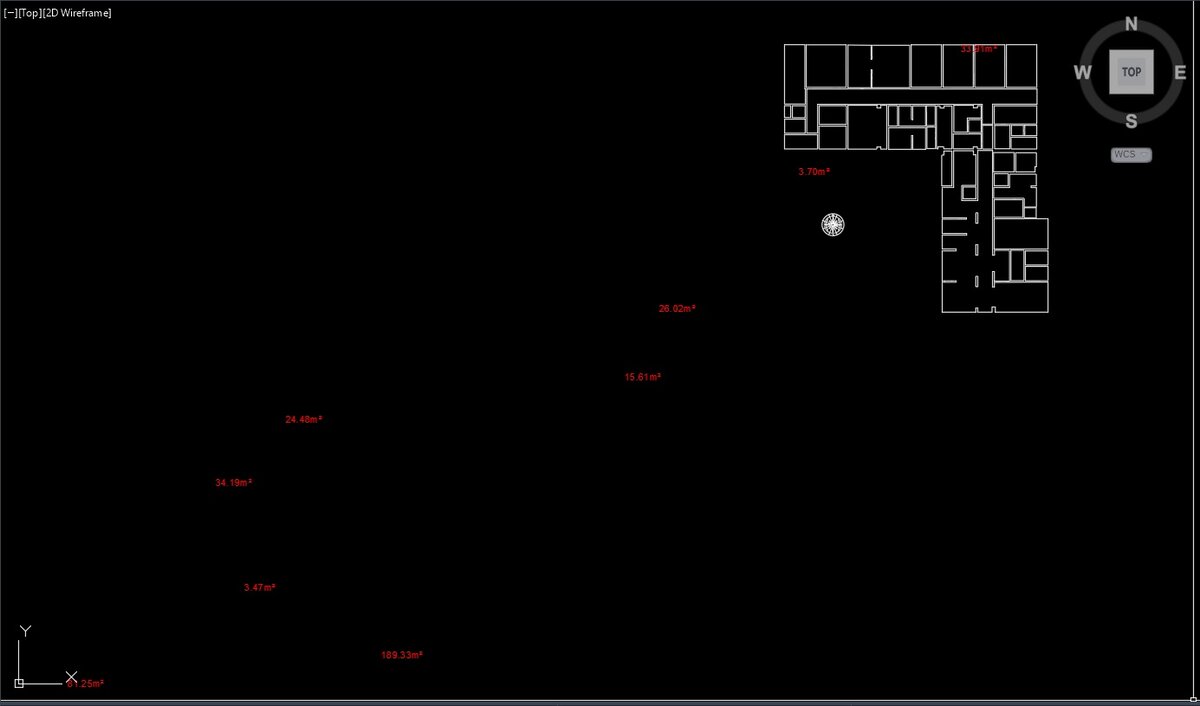

hello, can someone help me about this lisp
(defun C:UpisP ( / VisT BRDM ss)
;  (setvar "cmdecho" 0)

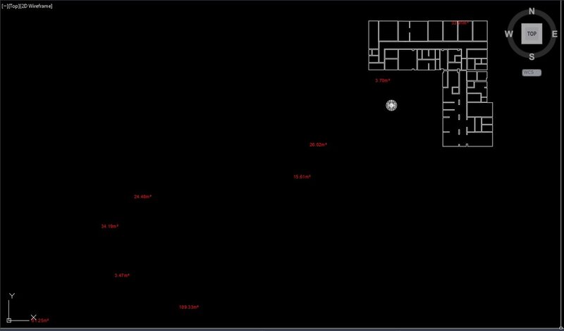

it sets my dimensions diagonally instead of in the middle of the room,
what's wrong with the code or maybe the autocad setting?

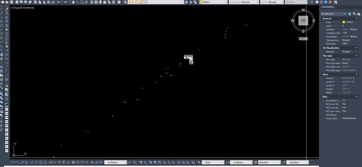

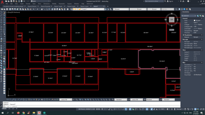

I've tried these lsp but they don't work properly for me.
I am sending you a drawing and a better picture with my lsp...
1p.dwg
does anyone have a suggestion? I have the impression that there is some little thing in the code, because sometimes on some drawings everything works properly (puts the value in the middle..)
does anyone have a suggestion and can anyone take a look?
Your plan is very far from the origin. This leads to inaccuracies in the calculation of the centroid.
: id
Select point to identify coordinates:
 X=6603203.81  Y=4643037.02  Z=0.00
