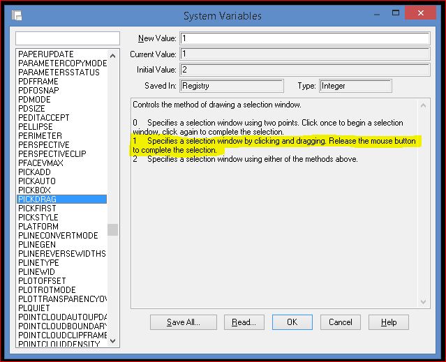

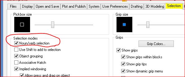

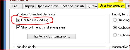

Dadgad Posted July 9, 2015 Posted July 9, 2015 See the screenshots, sounds like your PICKDRAG & PICKFIRST variables need tweaking. Quote

Gin Posted July 10, 2015 Author Posted July 10, 2015 Hi Dadgad, Thanks for your reply. I tried to unselect the "Noun/verb selection" & "Double click editing" but the result still the same. Except I setting the "pickdrag" value from 2 to 1. Previously I draw a line need to click 3 time only able to create a base point but now need 2 click. Quote

Dadgad Posted July 10, 2015 Posted July 10, 2015 Hi Dadgad, Thanks for your reply. I tried to unselect the "Noun/verb selection" & "Double click editing" but the result still the same. Except I setting the "pickdrag" value from 2 to 1. Previously I draw a line need to click 3 time only able to create a base point but now need 2 click. Sorry, I didn't mean to suggest turning off "Noun/verb selection" & "Double click editing", just confirming that they looked as they were in the screenshots, I should have been clearer about that. I would leave those both as they were, ON. Glad the Pickdrag variable provided you some relief. Quote
