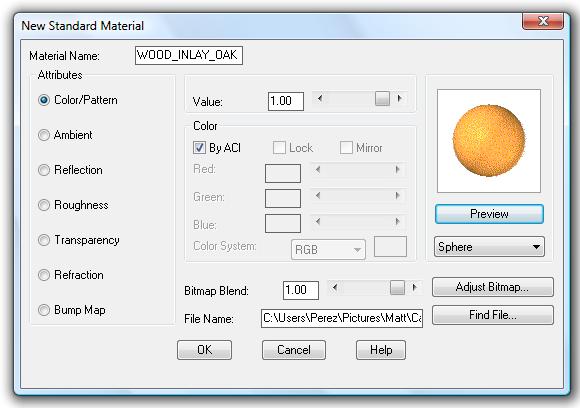

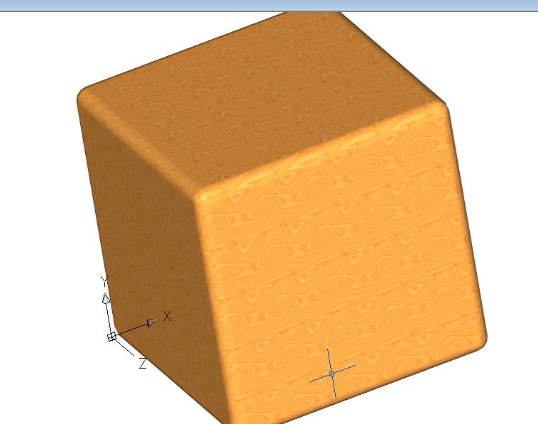

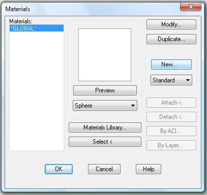

on your materials window you should have a button for New. Name the material what you want, i named my wood_inlay_oak for no good reason. then on the color/pattern window i clicked find file and used a large Jpeg image i had for wood. You also have control over the rest of the attributes and can add a bump map and transparency map if you wish. The third image is the material applied to a cube.
